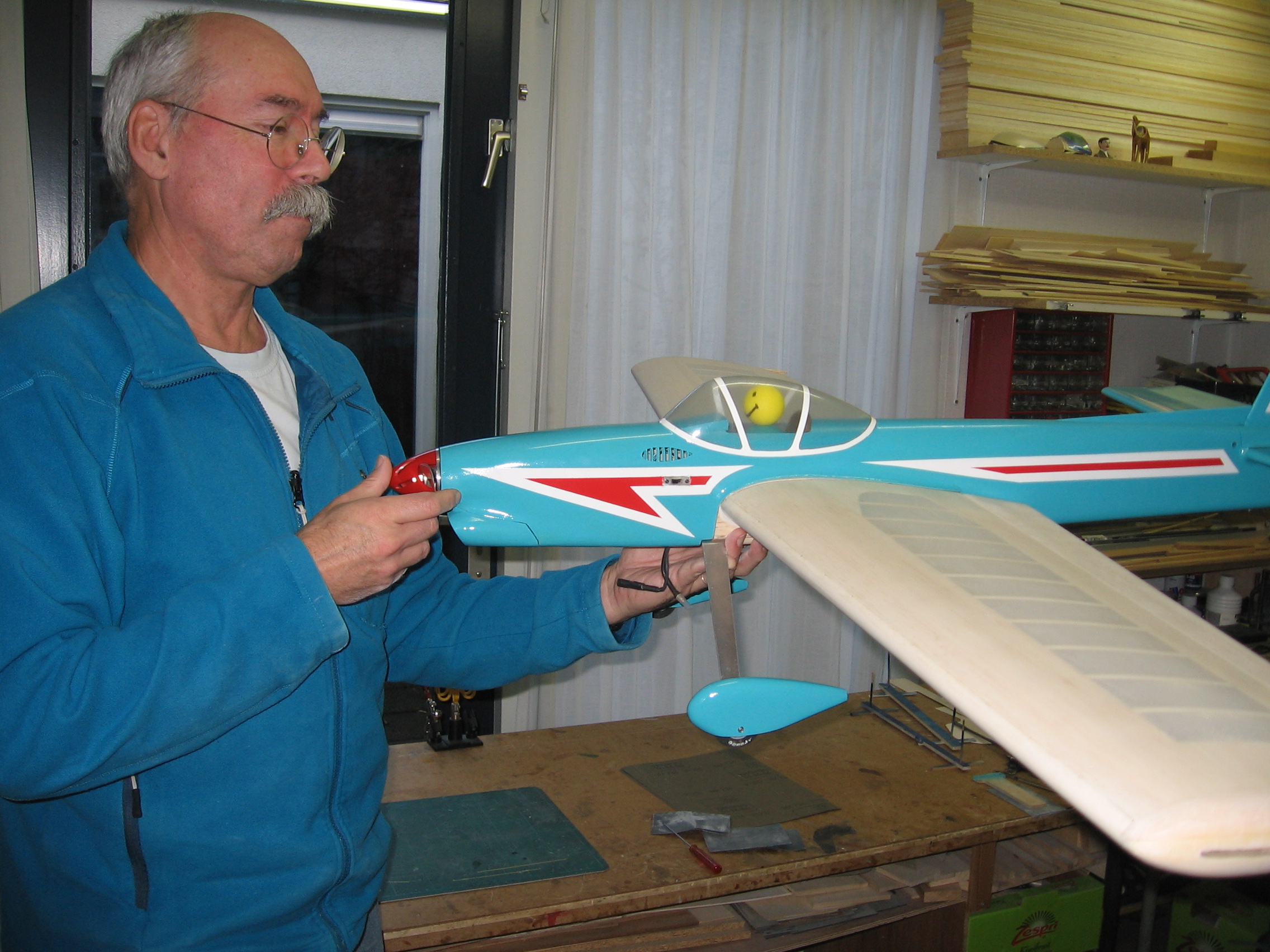

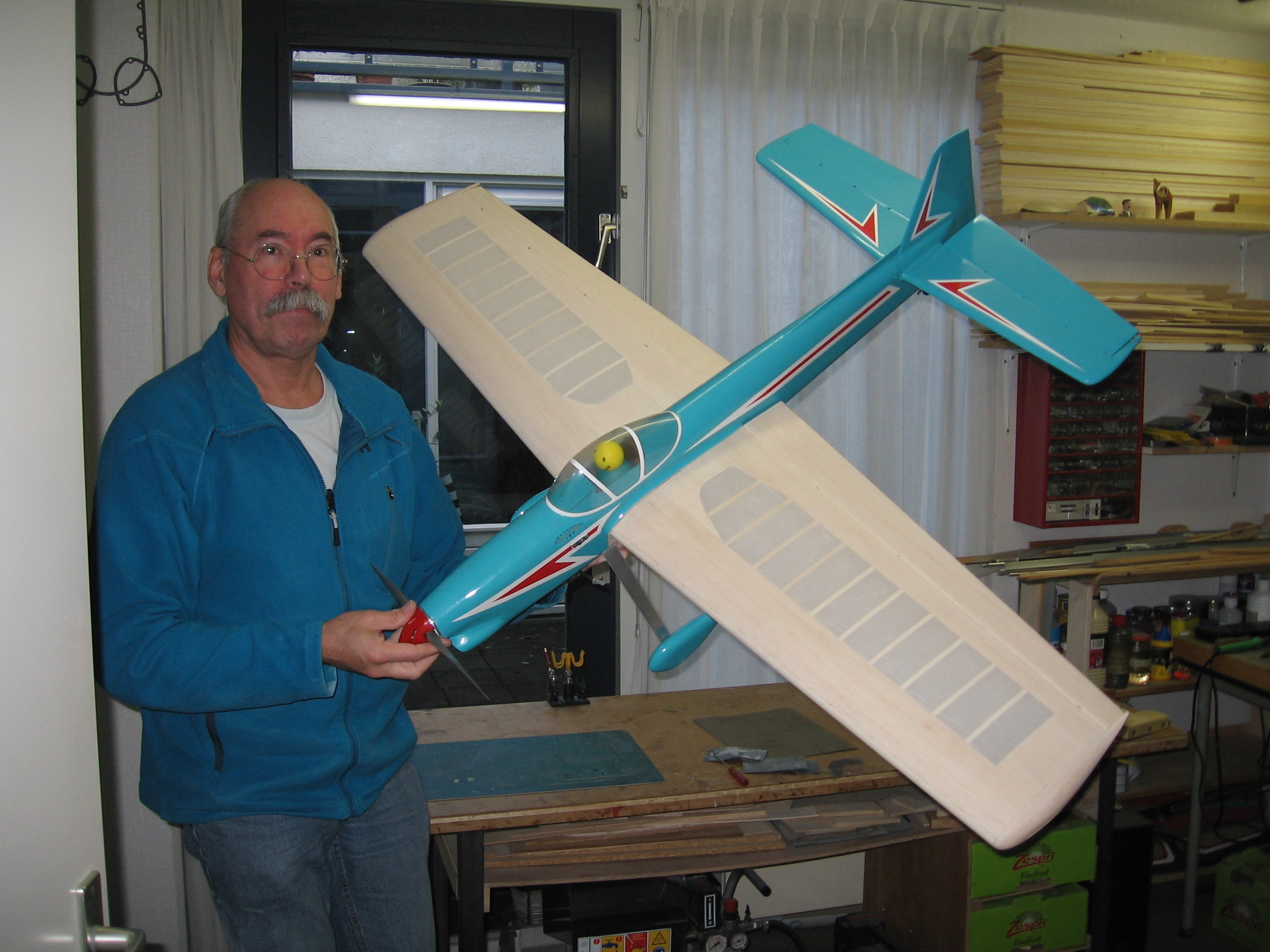

I'll share how we, on the other side of the Atlantic, tackle the subject.
We're using silk only for open bays, cutting it to size with ~ 1/2" overlap.
Moisten the silk, then put it in place and dope the contact areas to stick it to the wood.
Once he silk has dried (no dope as yet!), tissue is cut to size and also moistened. Then it's applied over the silk and also attached with dope to the wood.
Let it dry, then start building up 8 - 10 coats of dope, sanding lightly between every two.
The dope will not drip through the silk as the tissue will be the buffer. Silk and tissue will adhere, dope will shrink them together.
The combination of the two layer covering has two benefits:
The span wise strenght of the silk will make the wing resisting bending loads better, the tissue will 'lock' the weave of the silk, thereby transferring it's torsional strenght to the silk, that has hardly any of its own.
Because of the tissue, the silk won't take up anywhere nearly as much dope as it would on it's own. Almost all of your dope is on the outside.
The doped tissue, to a certain degree, acts as a filler, that is sanded down to a smooth skin.
We haven't found any weight issues, in spite of the two layers
We are experimenting with water borne dope and the first results are very promising. Time will tell....
The 2015 model with the 2016 ( 2 piece) wing:

For GonzoBonzo (like me, you must have areal name  H^^  ;)), I've attached the pictures again and some of the earlier stages.
As you can see, it's just as translucent as tissue or silk alone.

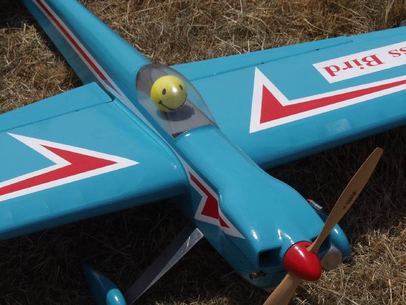

My new little -electric- 'Blitz' easily outperforms the '04 -ST 60- 'Bird', so we'll see what happens in Perth.
The 'Bird' has Polyspan covering, the first hole came within weeks, so I went back to silk/tissue...
