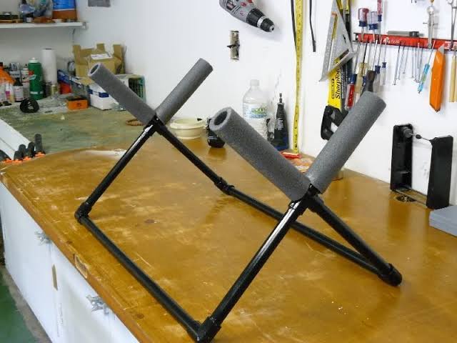

My Vector 40 is almost finished, and I think I need to have a stand to hold the plane either for starting the engine or doing some adjustments on the field.
I was thinking of building it with PVC pipes and I have found two common designs out there.
The “X” style and the “H” style.
The X:
The H:
Which one is the better option?

I always like to keep it simple. But with that said the X style I could see the plane flopping over banging a wing tip. The H style looks more like it will lock the fuse in place. With them being made of PVC if you don’t glue all the joints you can take it apart for storage.
I just use a piece of foam and lay the plane on it if it needs some maintenance. It keep foam in the truck to transport the planes.
Good luck with your Vector. Let us know if the motor mounts needed to be redrilled.

I did a portable stand from an adjustable keyboard stand that I got used from a local music store for $15. It can open wider if one likes but folds to fit in the car easily. Just added the foam pipe cover with a couple zip ties to protect the wings. If you build a PVC rake I would do one that supports the wings so it doesn't flop around.

If you use the H option, rather than using caps, have the foam cylinders extend a little above the tube tops.  Also, ensure that foam on cross pieces or any cable ties holding it can't rotate and dent your fuselage.
