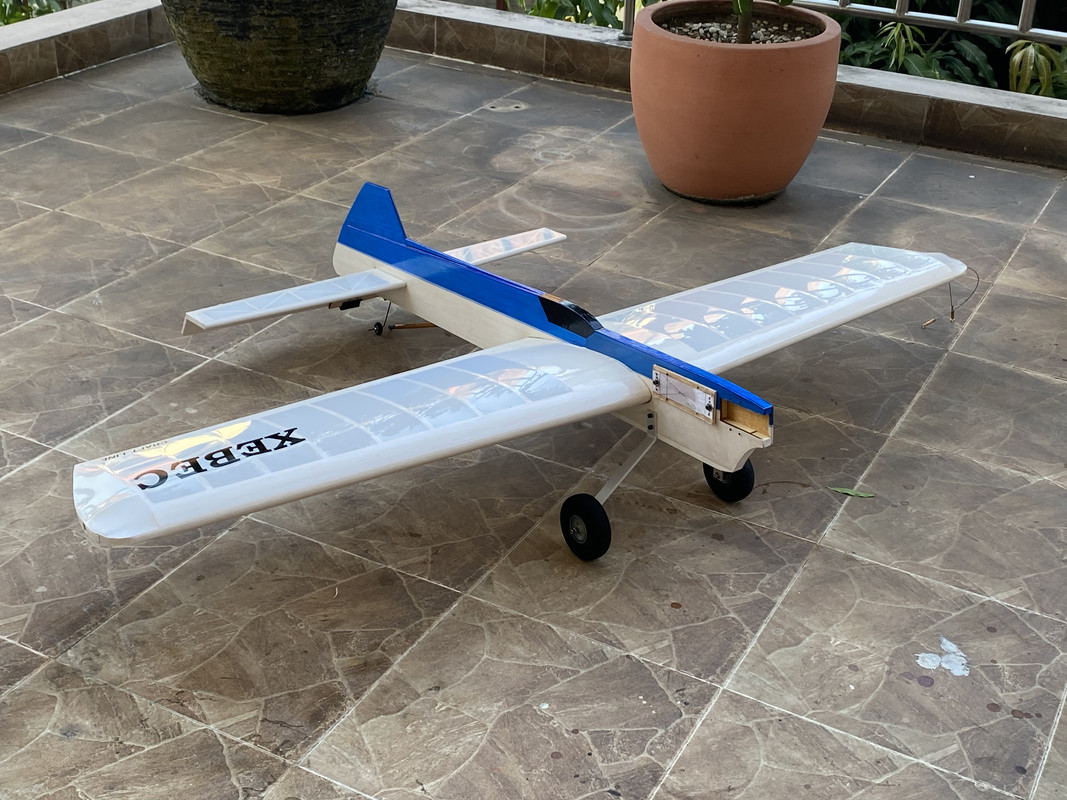

My XEBEC is almost finished. Currently waiting for the epoxy at the elevator to cure then will do the pushrod setting. I知 going to put OS LA-S 25 at the nose and 3oz uniflow tank.
The wing area is 500 sq. in. and the weight target is around 35-37oz dry.
What prop should I use? 9x4? 9x5? 10x3?

I would suggest an APC 10x4.  As an option a 9x4 might work but I have had better luck with the slightly larger prop with larger airplanes.  Airplane looks nice.  Have fun and enjoy.
John Paris
269
Re: 500 sq in Wing Area ; 37oz dry ; LA-S 25 :: What Prop Size to Start?
« Reply #2 on: August 01, 2023, 11:10:34 AM »
As stated start with 10-4.  Myself with 25 size engine(LA) i would start with a 9-6 or 9-5.  Use what makes the plane happy.  The plane looks great.  Now don't bruise the grass or pavement. H^^

9-6.  Be prepared to go to a 10-4 or 10-5.  I am not a fan of high rpm low pitch.  Always seems to fly the plane too fast for me.

I'd start with an APC 10-4, then make sure to at least try an APC 9-4.  That should be a good size plane for a 45LA.

  No way on the 9-6, way too fast. 9-4 to start, 10-4 as an experiment once you have the 9-4 working properly.

9-6 is good on a 40FP for sport carrier, so it's going to be too much for a 25LA.  If you want to go the low RPM high pitch route, use a bigger, spindly engine (like a Fox 35) and struggle with the 2-4 break.

Hiya Kafin
Looks pretty cool.
I concur with prop advice so far.  y1
You have fuel proofed the engine bay I assume.
You may need a heavy prop (APC) and a spinner to bring CG forward?
Waiting to hear how it all goes!
Have some great fun.
John Carrodus
  • Posts: 3703
« Reply #8 on: August 01, 2023, 06:26:55 PM »
A Brodak 40 would be a nice engine for that plane. For an LA25 on something that big I would use a Master Airscrew 9-4. It has less pitch, less load and more blade area than the APC. You'll want the engine revving close to it's peak HP in manuvers. Another good prop would be the APC 9.625 x 3.75N report is it works good on the LA25 / Nobler.
That's a nice looking plane, is it original scratch built?

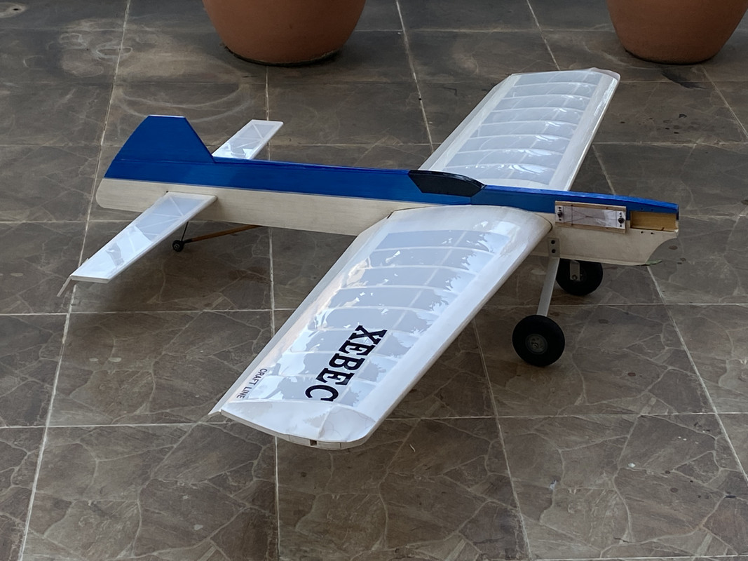

First of all, I'd like to say thank you all for your inputs on the prop size to start with.
The total dry weight turned out to be 28 oz, I was actually surprised when I found out. I thought the final weight would be around 35-37oz.
Given that I have a very light ship, I decided to go with 9 inch prop diameter, even though the wing area is quiet large for the 25 engine size.
I tried two props, 9x5 and 9x4.
And here's the details of my every flights:
1st flight (Maiden):
OS LA-S 25
APC 9x5
12,500-ish launch RPM
Avg 4.9 sec lap times
0.015 60ft lines
2nd flight:
OS LA-S 25
APC 9x4
13,400-ish launch RPM
Avg 5.1 sec lap times
0.015 60ft lines
3rd flight:
OS LA-S 25
APC 9x4
12,400-ish launch RPM
Avg 5.45 sec lap times
0.015 60ft lines
4th flight:
OS LA-S 25
APC 9x4
12,900-ish launch RPM
Avg 5.30 sec lap times
0.015 60ft lines
At the end of the day, I felt that my 4th flight was the best one (in terms of engine setup). Please advise if it still sounds too lean or not.
However, even though I like how the engine ran on the 4th flight during upright level, wingover, and inside loops, it showed some oddities when I was trying to go a full lap of inverted flight. The RPM seemed to drop and it flew slower yet the tension was decreasing. The moment I flipped the ship back to upright level, the power was restored. And after couple of upright level laps, I could do another inside loops easily.
I suspect this had something to do with the fuel tank height and the long lines I had.
It seems I need to move the fuel tank a bit higher and change the in-line filter so I can shorten the fuel lines.
Does it sound like a plan?
Looking forward to hearing more feedback from you guys!
Best,
Kafin
