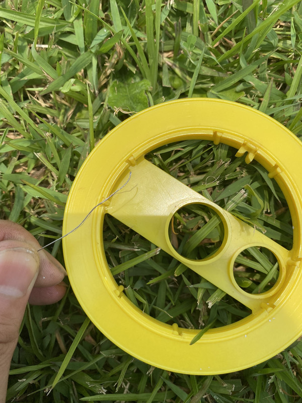

Thank you for your responses
After reading your comments, it got me thinking, beside the dragging that I often do, can storing method play some role here? How do you store the lines?
Here’s what I do after the last flight of the day:
- Run the lines and untwisting it from the plane back to the handle
- I disconnect the lines from the handle,
- Putting the end of the lines into the reel
- Start rolling them up going toward the plane
- Disconnect the lines from the clips on the plane
- Connect the lines back with the handle
- Clip the reel
- Put them into a ‘ziplock’ bag
- Store it in the flying tool box
What’s your take on this?
Best,
Kafin

« Reply #21 on: March 28, 2023, 08:15:09 AM »
The last picture has the reel clip in a position to impinge on the lines. You can use foam from a flip flop shoe as a cushion between the lines and clip.
  When I'm done flying a plane I unhook from the plane and wind towards the handle. Fishing supply stores have plastic boxes that are made to store the reels we use. Without handle of course. I keep handle and lines with the plane they are assigned to. Spare lines go in the boxes.

« Reply #22 on: March 28, 2023, 10:06:55 AM »
I do a variation of what Perry said.  I unclip the lines at the plane and roll them up to the handle.  I use a 5" reel and I have a wooden block that secures the lines rolled onto the reel.  I also do one more thing, I take the clip off of one line and leave it on the plane and take the other clip off of the plane and leave it on the line.  I never disconnect the lines from the handle.  I don't unwrap my lines after a flight, I do it before the flight (See Brett's post, I do it the same way).  That way I don't forget since it is part of my start up ritual and in competition, you have a thousand things on your mind - and a few in your stomach.  Knowing that your lines will be wrapped and not hooked up backwards when you get to the handle and how to spin them to unwrapped is just part of my ritual.
One point on using the 3" reel.  The side slot where the lines exit is a great place to get a kink if you roll the lines too tightly.  That is one of the reasons I use a 5 Kite reel".  It has a hole/slot in the side that keeps the lines out of harm's way when rolling them up.  I would recommend widening that slot so that the line does not bend much and make the first couple of winds loose.
It appears from that middle picture that you have a very nice place to fly!

The racing guys showed me an easy modification to the standard SIG line reels that helps avoid stress on the wire near the termination. The pictures show a window on the ID (no need to open up the side slot) so that you can avoid a sharp bend. On the inside of the reel, you can install a pin to hook the eyelets over to avoid the termination creeping up into the wrap area and again, causing unnecessary stress. It is an easy pair of mods and works great. I use it for all types of lines, and for all different events.
I make the pin from some 1/16" wooden dowel--or what ever you have handy. Press it into the spoke and hit it with CyA. I cut the notch with a burr in a Dremel tool, but you could get there with some small files as well.
  • Posts: 7040
Re: Untwisting The Flying Lines?
« Reply #27 on: March 30, 2023, 06:54:37 AM »
This is a great idea.  Avoids the side slot all together.  I just got a shipment of the reels that Spectra comes on since I couldn't find any SIG and it looks like that source is gone for good as well.  Going to make them up like this.

I just drill a 1/8" hole and use a #4-40 screw for the pin.  Works great.
- Clip the reel
Best,
Kafin
That is essentially how Paul Walker taught me to do it. The only thing I do differently from you is I keep something soft wedged between the clip and the lines.  A piece of foam, a wad of paper towel, a piece of balsa, anything soft that wedges in there.  Roll up the lines, stuff the soft piece of whatever down onto the lines, then snap the line clip down over that to keep it in place.  Keeps the clip from imparting any bending opportunity on your lines.
Gary
