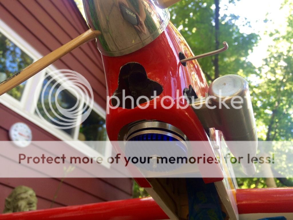

 Just got magnum 52 blue head in the mail hopefully have a couple tanks of fuel run though it by monday evening.Got to get a venturi made monday morning. Cant hardly wait !!!!.
Offline B Norton
  • B-NO
  • Posts: 111
Re: magnum 52 xl blue head
« Reply #22 on: June 26, 2016, 02:59:04 PM »
Went out to Bob Reeves shop this morning to use his lathe to make a venturi.Used some dalron made it with a .281 opening used a super tiger 51 needle valve .Put to tanks of fuel through it ran perfect!!from a wet 4 stroke to a fast two stroke in a half turn of the needle cant ask for much more than that I'm very happy!

The reason I went with this motor was because I needed good reliable engines at a cheap price, and since they quit making the LA 46 I needed something. I  could auger in three or four of these engines for the price of one nice stunt engines.With me just starting the pattern again it just make more sense .I own a really nice ro jett 61 but I'm not there yet.Just explaining sorry about the ramble.
Offline B Norton
  • B-NO
  • Posts: 111
« Reply #37 on: July 09, 2016, 01:27:13 AM »
Well score is finished maybe get some flights in this week and find out just how good this motor is!
Offline B Norton
  • B-NO
  • Posts: 111
« Reply #38 on: July 13, 2016, 11:43:02 AM »
After a lot of work I got elevator & stabilizer fixed on the score now if the wind dies down a little ill see just how good this mag 52 is .I guess that's what I get for leaving the score with no monocote on it for almost ten years.

OK finally got to put a couple flights in on the score and the magnum 52  the score flew well very stable has a couple trim issues very fixable not bad.The magnum plenty of power might need to experiment with props to get that sweet spot but exceptable like it very much.
That's a pretty dope score B!
