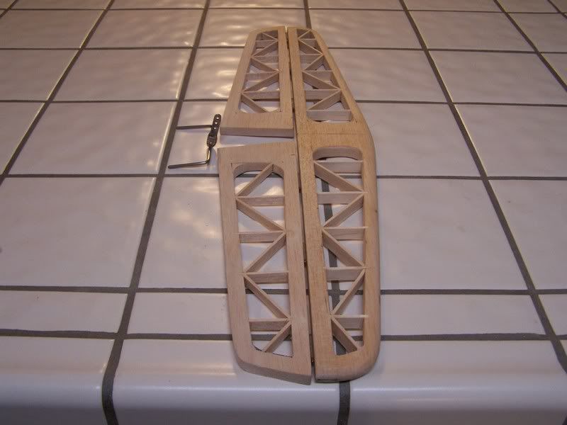

Charlie Pate is this hwat you mean by offset horns? My KA-10 Stab/el horn

« Reply #5 on: December 13, 2006, 05:38:59 PM »
Right for the stab!
Wrong! for the flap
Email me, we,ll fix it!

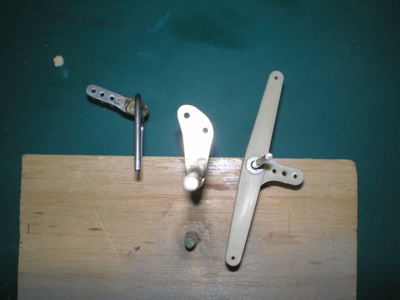

KA-10 ELEVATOR HORN BENT , FLAP HORN UNBENT ,BELLCRANK

The way you have the elevator horn bent is NOT a good idea. It needs to be at a 90 degree angle to the horn. This keeps the elevator movement the same on the up and down side.

I think Walter's horns will work fine for the stock KA-10 (which has wing and stab inline). It would correct the control system geometry, for this configuration, tho maybe the angle is a bit too much. If Manuel's modified KA-10 has similar horns, it would be bad news. In all cases, the control horn should be at 90 degrees to the pushrod (assuming the pushrod is straight, no doglegs allowed).  :! Steve

Stock horns in mine, 100% symetric layout.
Thanks for the advice.
