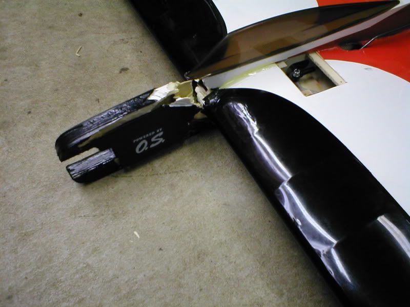

We had a little mishap at our Fall Fun Fly. I figure I will just make a new fuse.

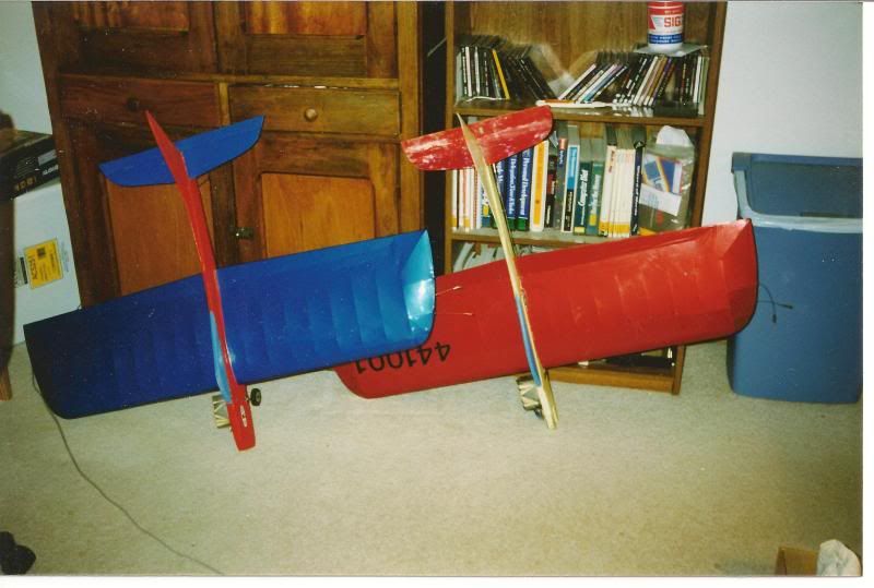

I have been flying a Flite Streak wing in a Skyray 35 fuselage since about 1994.  It happened the usual way, a salvaged Skyray fuselage section and a salvaged Flite Streak wing met in a workshop, and the rest is history...  Turned out it flew MUCH better than either the stock Flite Streak or stock Skyray.  In fact I liked it so much I built another Skyray fuselage from scratch to mate with another salvaged Flite Streak wing, and made it look more like a Flite Streak.  Both planes have been flown extensively, been rebuilt a few times, and have broken 500pts flying in PAMPA classes.

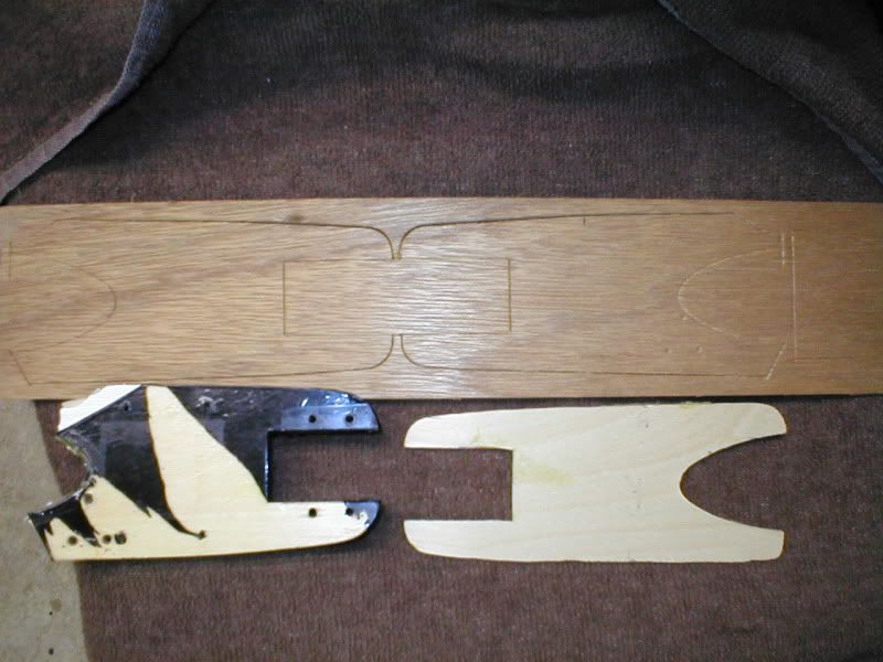

Earlier this summer I pulled it back out and thought about how I wanted to fix it.  I mentioned the doublers earlier.  There are actually two different doubler patterns that Top Flite used, the later of which (the loose double in the pic) extended a bit further back on the wing, but both extended further then the ARF version.  Regardless how I repaired it, I was going to stretch the doublers back to the kit dimensions.

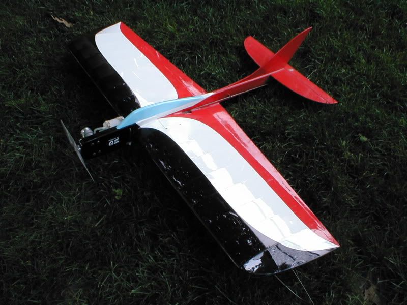

I never much cared for the ARF, even with the FP 20 setup it never worked as well as the Skyray 35 fuselage versions.  I didn't want to invest much time or the materials into building a new fuselage for the broken ARF.  Instead I drew up a plan for the ARF style nose, but stretched an inch longer, and with the late kit style doubler outline.  I also narrowed the mount spacing to fit an FP 15 instead of the 20.  With the new nose built, I epoxied it to the original fuselage.  The ARF canopy didn't survive the salvage, so I cut a sheet balsa canopy to double the joint at the top of the fuselage.
So far it's worked pretty well.  It flies almost as good as an original kit wing in a Skyray fuselage.  Grafting a new nose on the old fuselage was more affordable than cutting a new profile fuselage.  From bare wood, the new nose received a few coats of spray on Duplicolor primer, and Duplicolor truck & van spray can paint to match the original Monokote.
If you cut a new fuselage from 1/2" sheet, or build up a profile fuselage like the ARF, I'd recommend copying the Skyray 35 fuselage.  If you're cheap like me, a new nose can be successfully grafted onto the old fuselage.  Slightly stretching the nose for more tank room won't upset the design since the ARF is already stretched in back.  A shorter tail would just mean adding ballast to bring the CG back.  Even with a forward CG the Flite Streak flies fine, I don't know that I'd worry about it too much.
