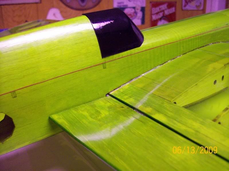

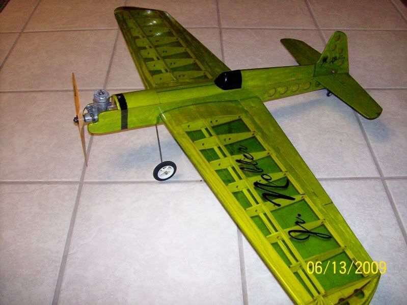

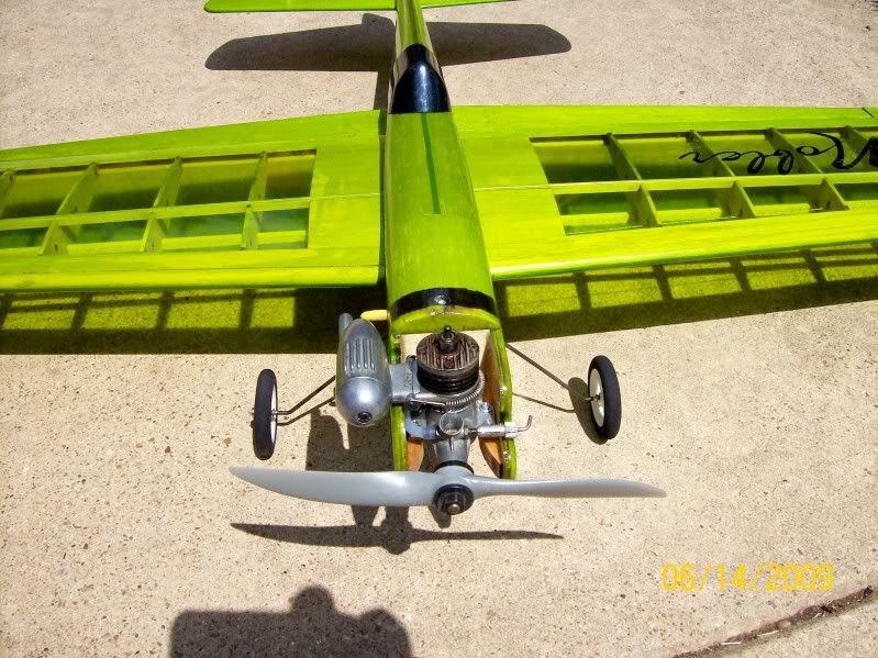

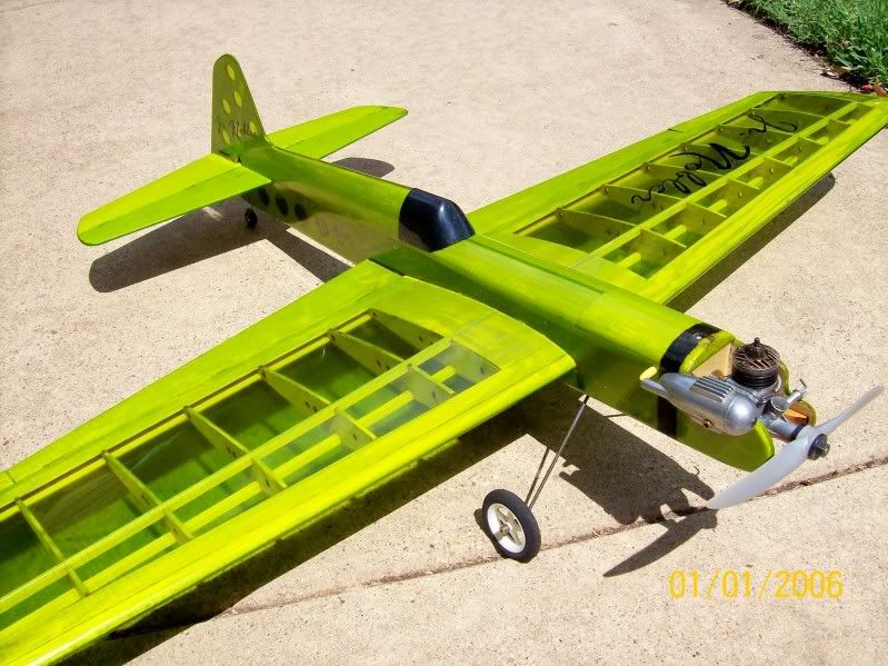

Jr. Nobler pics
« on: June 13, 2009, 08:16:47 PM »
OK, here it is. It came out at 17 oz. Tomorrow It flies.;@

OK, flew it this morning. Plenty windy, handle spacing too wide, .012 lines 52 ft. (too big, going to Spider Wire), but it flew OK. Stable enough, but turns like a combat job. Only problem: 3 min. engine runs with the Fox on 1.3 oz.of fuel. New Great idea: I have an OS Pet .099 that is going on the scales and will be timed on 1.3 oz. fuel. It has to have better fuel economy, and if I remember correctly it weighs very little. Might be a winner  We shall see.....

REVISION #1: Went with the OS PET .099 and it weighs the same, but has a muffler and, best of all, has a five and a half minute run time. APC 7-3 seems to have have enough power. Now to make a different handle and change lines......
The Bug- Juice green color was chosen by my wife..... not my favorite for sure, but it's growing on me. It's real hard to tell the color when it's on the roll in the store...

Perhaps I'm a bit confused. Isn't that a Pet-II in the pics? Pets were sport engines and had a little less power than the .10, but they were still good engines. What muffler are you using?
