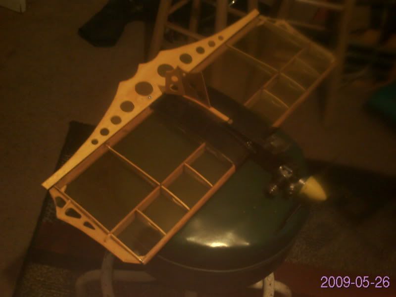

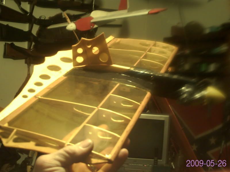

I'm the proud owner of a used[bench run only]Medallion cox .15 and it has tons of compression. I have an idea this little engine is gonna be fast. So, being relatively new at this type, which plane/size/type would y'all experts suggest? I have the TD .09 engine, and I built this copy of an e-flight plane I built that I fly with the .09 but I'm pretty sure I'll hafta go quite a bit larger. Thanks for any suggestions H^^

The wing on this plane is 24" x 8".

John, what do you use to cut all those nice circles and shapes in your balsa? I always seem to have troubles even with sharp blades in my zacto when going against the grain!! Nice looking little combat ship.
Re: My first cox .15; which plane?
« Reply #16 on: December 16, 2009, 08:21:01 PM »
Different sizes of tubing serrated on the edge and twisted on the lines. y1
