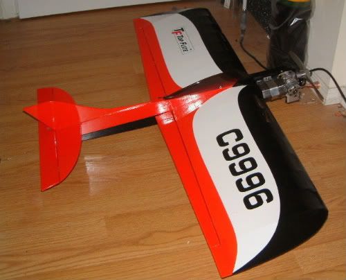

I'm now on my 2nd Flite Streak ARF. The first will fly again, but with a new fuse made of solid balsa, ply and extended fore and aft. The 2nd FS needed the nose rebuilt after the 5th flight, due to a botched stooge launch. I put in 2 wooden dowels, 6" each, from just behind the motor mount extending back to mid wing. Since the fuse is hollow, this was easy. Then I doubled up the ply on each fuse side back to about mid-wing. On the fuse-side opposite the motor, I didn't bother make the u-shaped cut-out. (The 2nd FS had alot of vibration in flight, right down into the handle.) I also took the time to put in a 2-wheeled landing gear.
I've got about 20 flights on it thus far .... with no repairs. I've been able to really start trimming it out, and doing some basic stunt practicing. Counting off in my head .... I think I'm around 5 sec. laptimes, with a OS 25, 9x5 prop, and 60' lines. On this same basic setup with FS #1, I was low-mid 4 seconds ..... The rebuild of the fuse in FS #2 has made the plane heavier, thus alittle slower.
Next time out to the field I gotta figure out why my loops look like an 'upright #9'. Starting the loop is pretty tight, but the last half of the loop the plane seems to fall off and struggle to complete the loop. I got a feeling that I need some more weight in the tail. I moved my handle line spacing out (which helped), and elevator throw seems to be more than sufficient (at least 1/2", from memory). With FS #2, I've never been able to get the 'start' and 'end' of the loop on the same line. Maybe the extra weight and slower speeds is causing it .... before adding tail weight, I may try a 9x6 to bump up the speed.
Ahhh .... the trials of experimentation!, but as long as I can fly without some sort of repair to this thing, then its all good!
After building a fuse for FS #1, I'm definately going with a kit plane. By that time, the new Evolution 36 should be out. I wanna try that engine. I've got a Evo 46 in an RC plane, and its a wonderful engine.
Pic below is FS#1 during maiden flights. I've learned alot since then ... :-)
Babbling now ..... FlySafe! Larry (Larrys4227)
