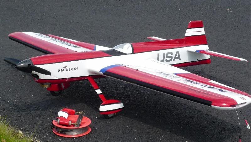

I was surprised that it's stalling also. It's a ST 60 powering it. The airfoil is the SV-11 wing, but he put bigger flaps on compared to the regular SV wing planform (3 inches at the root, 2 inches at the tip).
Here's a picture of it, you may have seen it at the NATS.
     That does surprise me, although it would less likely to stall if you put in a PA40/51/61/65 running 4" of pitch. Try the turbulator trick, that's usually our last resort solution.
    I presume that you have already sealed the flap and elevator hinge lines.

« Reply #18 on: August 30, 2011, 05:39:13 PM »
Yep, hinge lines are sealed.
All the extra rear exhaust engines we have (2 PA 40s, and 2 OPS 40s) I think are too small putting in a plane this size.

Matt, are you sure it isn't just hinging in the corner? That would make much more sense than a stall at the given weight.
Also, bending a rod in the accident the ROJett 76 was in seems a bit improbable.  I suspect a leak or other problem in the fuel or exhaust system from the cash or the repair process as much more likely.
Good points.  I was thinking that about the rod, too.  What are the symptoms?
I might have thought it was a fuel system issue, except the motor doesn't feel right when I turn the prop over, it doesn't sound right, and the needle is a full turn out from where it was before the crash to get the right RPM.
The header was loose when we inspected it after I flew it to see what might be the issue.  We tightened the bolts and mounting bolts just to see if that made a difference, and other than running a little quieter, made no difference in the feel, and sound of the engine.

The odd thing about Matt’s plane stalling is the wing loading is in the proper range.  I am wondering if there is a control issue.  I had this very thing happen to me several planes ago.  I built the model 675 sqrs 60 oz.  It was stalling horribly in last corner of the triangle and hourglass.  It was a tad tail heavy but that wasn’t the issue.  It was flat out giving up in those two corners.  In most other areas of the pattern it was very flyable.  It had removable flaps so we tried bigger flaps.  No change.  We tried MAAAAAAAAAASIVE amounts of nose weight to cure the tail heavy feel as well.  No change.  Tried flying it faster and faster as well.  No good.  It just didn’t make sense why it would stall at that wing loading.  Finally one day we stuck a protractor on the side of the plane and measured the deflections.  DING DING DING!!  Turns out I had made the mistake of flipping the pushrod connections at the flap horn.  The elevator was deflecting way way way more than the flap and it was cause of the stall.
We quickly put the plane under and performed surgery.  We went in through her under belly to get to the heart.  An hour later and she was recovering nicely with no noticeable scars.  After a nights rest the next day she was able to perform as expected and became a good flying plane in my stable for quite a while.  I was able to take out all the nose weight and retrim it into a very good flying plane.  She remained one of my trusted warriors until she was traded to the northeast.  They treated her well and flew her all the time.  I saw a pic of her taking off at one of the Brodak Flyins in Flying Models.  I think she still flys some patterns from time to time somewhere.
Check those controls.  Even just a few more degrees elevator than is needed can really cause some issues.

Maybe, just maybe, you are hitting the corner too hard. As Billy use to tell me "Fly the corner! Even hard corners have to be flown".  I think some of these guys overcomplicate problems. Speed the plane up a little and fly a little softer. I watched you at the nats, if there is one thing you do have, it's corner.
Derek
Hi Derek,
The night before the flyoff, I was flying with Richard Oliver, and got some coaching from him, Frank McMillian, and Les Demmet.  After we quit for the night, I backed off on how hard I was flying the corners. On video, they still looked razor sharp but the whole pattern was a lot smoother compared to top 20 day, where I occasionally overcontrolled it, and popped up slightly.
When I first saw felt and saw the plane stalling on the triangle, I thought I hit my own air since the plane shook as well as sink.  I backed up a good amount where there was no way I could hit my own air again, and the plane did the same thing.  On the hourglass, all it did was sink, it didn't shake.
I think those Vortex Generators may help it out.

Holy Cow!  I drop a little note two days ago and come back to find a novel!  Lots of interesting thoughts here.
I'd add two items I didn't see addressed in a quick run through.
First.  How sharp is the leading edge of the wing?  Brett and I could stall the first Great American ARF-OFF winner at will with the leading edge the way it came out of the carton (I forget the name of the ship.  One of Windy's that John ARFed with a big wing and huge flaps.)  A STREGA!  That's it. (They say the memory is the first thing to go...I don't remember who "they" were)
At any rate.  We took it to our flying field a week or so later along with some rasps, sandpaper and sticky monokote.  We rounded the leading edge as much as we could with the 1/4" square leading edge under the sheeting.  After that it was impossible to stall.
Second, I can't tell much about the flap configuration on the P-40 from the picture.  How large are they and are they full span or shorter?
The original TP, for instance uses less than full span flaps (which I prefer because the hinge loads are lower and the input forces less) which provide a poppier corner.  However, because it is severely weight challenged it had a tendency to stall in hot muggy weather.  I very slight increase in flap deflection for a given amount of elevator input was the final fix and it doesn't stall anymore.
The TP was also the first ship we tried the control wire turbulators on at a very muggy and drizzly team trials where it was stalling in the last corners of triangles and hourglasses.  The wires got us through the team trials just fine but the increased flap movement was a neater, and thus far equally effective, fix.  Hasn't stalled in many a year.  Worth noting that it currently weighs 72 oz and has a wing area of ~650-60 square inches.  It has also won a Team Trials, four Nats second places and two third places.  Pretty good record for a ship that's "too heavy" to fly well.
At any rate, let us know how long the span of the flaps is relative to the wingspan and the chord of the flaps at the root and tip so we can do a little grade school math (I leave all the complicated stuff to Howard and Brett who speak "numbers" fluently).

Hmmm, just looked at the picture and it looks like the flaps extend all the way to the tip and you said they were three inches at the root and two at the tip.  Couldn't get much bigger than that and you also said they're one to one ratio.
Give us the word on the leading edge, and then...
Where is the CG located at the average chord.  If an airplane is real nose heavy it can still fly well if the controls can drive it to the required angle of attack but the forward CG also causes the lift required for a given rate of turn to increase because of the extra down load on the tail which increases the "weight" that must be carried by the wing in maneuvers and also demands more control deflection.  (Remember, if you move the CG forward enough you can get to the point that you need full up elevator to simply keep the nose level!)
Couple of things.  If the ship needs lots of deflection the flaps will increase the camber of the airfoil and, thus,  the angle of attack commensurately.  The resulting lift is necessary and, thus, desirable but the large deflection angle could also drive the wing closer to its critical angle of attack (the point at which the wing stalls no matter the speed at which the airplane is flying...what we call an accelerated stall in the biz).  This is, again, the primary reason I advocate aft CGs.  Takes less control deflection, requires less lift in maneuvers and has less tendency to open up in the wind.  Of course, how far aft you can go and maintain positive control-ability is limited by the tail volume and static margin (big tails).
At any rate...where's the CG and how big is the tail?

The tail is 22% of the wing area. Not the biggest tail size in the world, but better than some. I don't remember the exact place where the cg is but it's just aft of the high point of the wing.
The flaps are full span, and the leading edge is definitely not sharp! I don't know how round it is if you want a precise measurement, but it's got an average round leading edge (it's an SV-11 wing with his own flaps and round wing tips)
