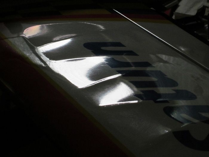

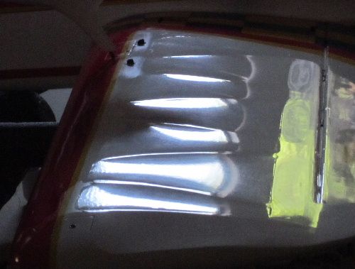

Just wondering if fairly deep scallops formed on a geodetic type wing would effects flight characteristics?
Thanks in advance
« Last Edit: July 22, 2013, 11:01:13 PM by Joe Yau »

Well I have serious doubt it has any appreciable effect, in free flight we (some of us anyway) referred to that as creating an "average" airfoil section. Geo or conventional, the actual section of the airfoil lies somewhere between the rib camber line and the drawn down curve of the covering. If you lay it out you'll find it really quite minimal.
Re: Scallops on wing Q..
« Reply #2 on: July 22, 2013, 10:35:38 PM »
Just curious, but how did they form?  Is that a plastic (ie monocote) cover or just tight shiny doped silkspan, etc.??
I don't know exactly how it got that way..  (didn't build this one)   I believe it's doped/polyspan.  This plane does have stability issues in level flights.

Built in turbulators.
Usually things like that happens when the builder runs the grain of the covering material chord-wise, instead of span-wise. When you say it's unstable in level flight, what is happening?

What George H. said.  y1
Except not as bumpy as rat droppings. LL~

I think it has the effect of reducing the airfoil and changing its profile. Why use a good airfoil and then reduce it to that n1 n1 n1. Looks like some ringmasters I have seen.

The covering as I see it in the pictures should not hurt the flying performance of the plane.   I have had several that look like that until I learned that iron on coverings have a grain/shrink direction to them.   How many know that the shrinkage is along the length of a role of iron on coverings.   Silkspan and poly-span have a grain to them that should run span wise other wise you get what you see in the pictures.   Silk and nylon have to be pulled more span wise than chord wise also.   As far as the plane wandering in lever flight, in some cases it was stiff controls for me.   Also if things are not lined up with each other loose controls will be the culprit.   Most of all and I have done it,  pilot not holding his hand still while turning/walking in the center of the circle.  Wish I could see the plane in person so I could really tell you.   But, as stated before, get someone else to look at the plane in person and/or fly it.
