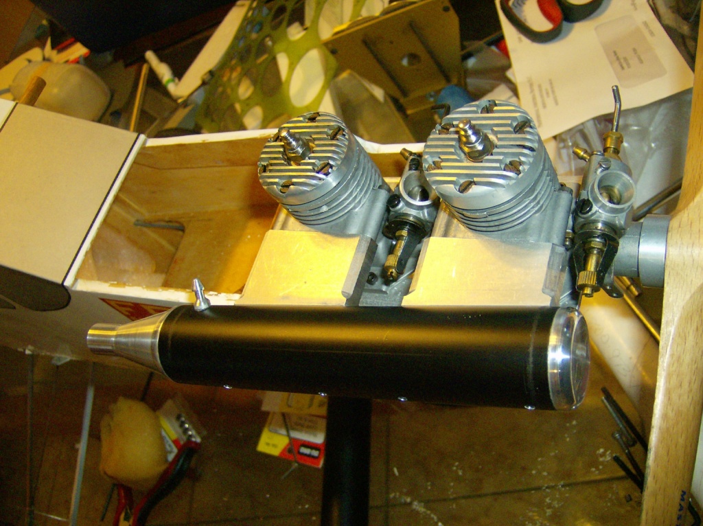

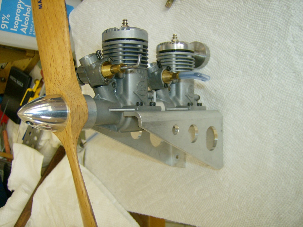

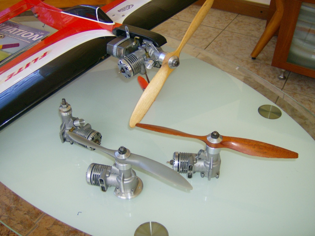

      I usually read everything I can on the Supertigre C.35 as is one of my favorite engines. This thread will help me on a project I have of an Inline Supertigre .70 twin I made. I had not noticed that the engines have subport induction. I measured the gap and it is.019 inch on the ones I have. The .020 inch shim should stop the Subport induction and I will be trying that on my twin. If you use the .020 shim on your engines you will have to lower the head on the liner by .020 inch to regain compression since your combustion chamber volume will increase with the shim. Removing the factory shim might not be enough and the head will have to be machined. I made a muffler for the inline twin to help quiet the engine and stiffen the joint between engines. I  fly control line and at this time i have an ST C.35 in my Flite streak using a Brian Gardner ABC P/L.   I `m building a C/L plane at this time but will try the shim idea on the Flite Streak later on to see how it helps with the noise.

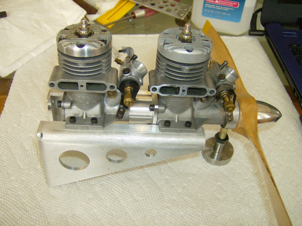

A friend of mine specialized in "building" twins. Here's a snap of one of them.
