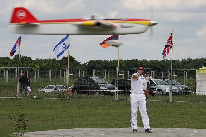

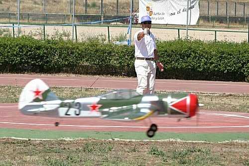

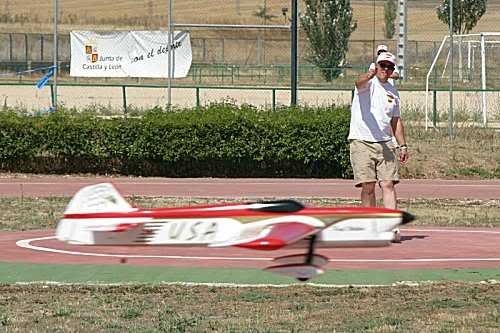

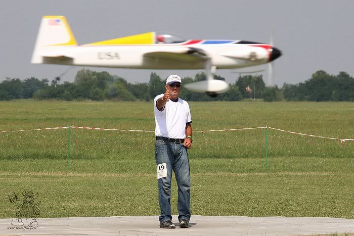

« Reply #22 on: September 28, 2011, 12:48:13 AM »
Bill : I fly with my arm straight out - However I like Paul Walkers approach - the handle slightly tilted.. Look at the last 2 photos for the reference
I have included some other photo's of notable fliers. - Just to see how World Champions look.. Where the handle position is.
Obviously excuse me from the list...... - My photo is only there to answer the question about my style..
Billy Werwage
Dave Fitz
Han Xing Ping
Bob Hunt
Orestes
Richard Kornmeier
Paul Walker
P.J Rowland ( yes I understand how out of place my photo is here... )
Paul Walker Again.. - Note the handle angled slightly.

Good pictures, PJ.  I suspect Mr. Walker is doing an outside loop in that last picture.  His neutral is generally straight up and down, although he has varied a little.

Im not so sure about that Howard...
It certainly looks like a level flight setup to me.. If it was a manouver the posture would be different, with more brace.
Plus the fact these photo's were taken on the same flight, and its fairly obvious where the manouvers are being flown.. I think its just level flight.

Looks like these guys are all flying with their arms straight out and some holding ubiased handles with some bias.  Also looks like everyones hand is in the natural slightly down position.

The only way to really tell the angle of the handle in pictures is to take them from 90 degrees to the flyer. In the pictures above the long lens forshortens the angle and is very deceptive. At the upcoming Huntersville contest  I will try and take as many pictures of flyer's hand position as I can from the 90 degree angle while they are in level flight. I will take everone at the same focal length. I think better flyer's fly with there hand at the chest position and go to the relaxed position during level flight. I think chest height is incorrect,neck or top of the shoulder height would better explain where there hand is.
Thanks Ed.  That will be interesting to see.
Re: Handles and Handle Bias
« Reply #31 on: September 28, 2011, 05:53:13 PM »
The photo's supplied were not specific in relation to handle bias.
It was in reference to a previous question about If I fly with straight arm or bent.
Example :
Actually PW is just flying vertical 8 ... guess how I know VD~

As someone who has flown with Paul for about 30 years I can attest to the fact that he is in the middle of a manouver.  His stance proves it.  It is the bottom of something with up control being given.  Paul flies with his handle in a vertical position during level flight both upright and inverted.  Flying in the Pacific Northwest, you get to observe some of the best flyers around.  Most if not all the top flyers keep their hand pretty much vertical.  Ted gets a little sideways during inverted flight but Brett, and David could be listed as poster guys for the straight up and down handle position
Alan,
Ya caught me out, didn't ya!  Yeah, I've laid my hand sideways (palm up) flying inverted for pretty much my entire "stunt life".  I'm absolutely convinced that trying to rotate it 90 degrees to vertical while flying inverted would increase the cost of balsa by a measurable amount!I must insist, however, that it is only in inverted flight.  I believe it is safe to say that outside maneuvers are done with the handle vertical.  Just for fun, try to "simulate" flying the top of an hourglass with your hand horizontal and palm up!  Pretty much doesn't bend that way!
