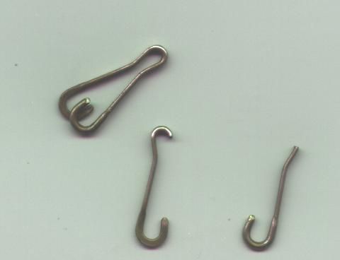

Here's one I put together from Keith's idea..

The fishing tackle squeeze clips don't last forever.  The spring tension goes away before they fail.
I'm in the process of phasing out the fishing clips in favor of clips made with the Derek Moran/Jim Lee clip bender.  The round wire works better anyway.  Since it's round it doesn't wear out the holes in my hardpoint handle, they don't get cocked on the leadouts/line eyelets, etc.

Thanks for pics, Andrew. I guess checking the connectors and lines each session is a must. Didn't think about the connectors loosing spring tension.

Those clips look abused, I've never had one break or lose tension. You must be opening them up too much and bending them.
You can take a new McMahon McRosco McWhatever clip out of the package, and squeeze it.  Then take one off a handle or set of lines that's actually been used frequently, and give it a squeeze.  You can feel that the used clip is softer after having been squeezed several times.  They always loosen up with age.  In normal use, the squeeze open action bends the clip.  It's just brass, and eventually it'll break just like bending a paperclip back and forth.  The point I was attempting to illustrate, is that eventually that bending will effect the brass.  Fortunately, there are plenty of warning signs before they fail, like most of the chrome wearing off, no longer returning to the fully closed position, and a fairly obvious loss of spring tension.  It takes a lot of use, but they do eventually fail.
I don't know that a hard stainless clip would last as long, or longer, but they have enough other benefits, and they're cheap enough.
