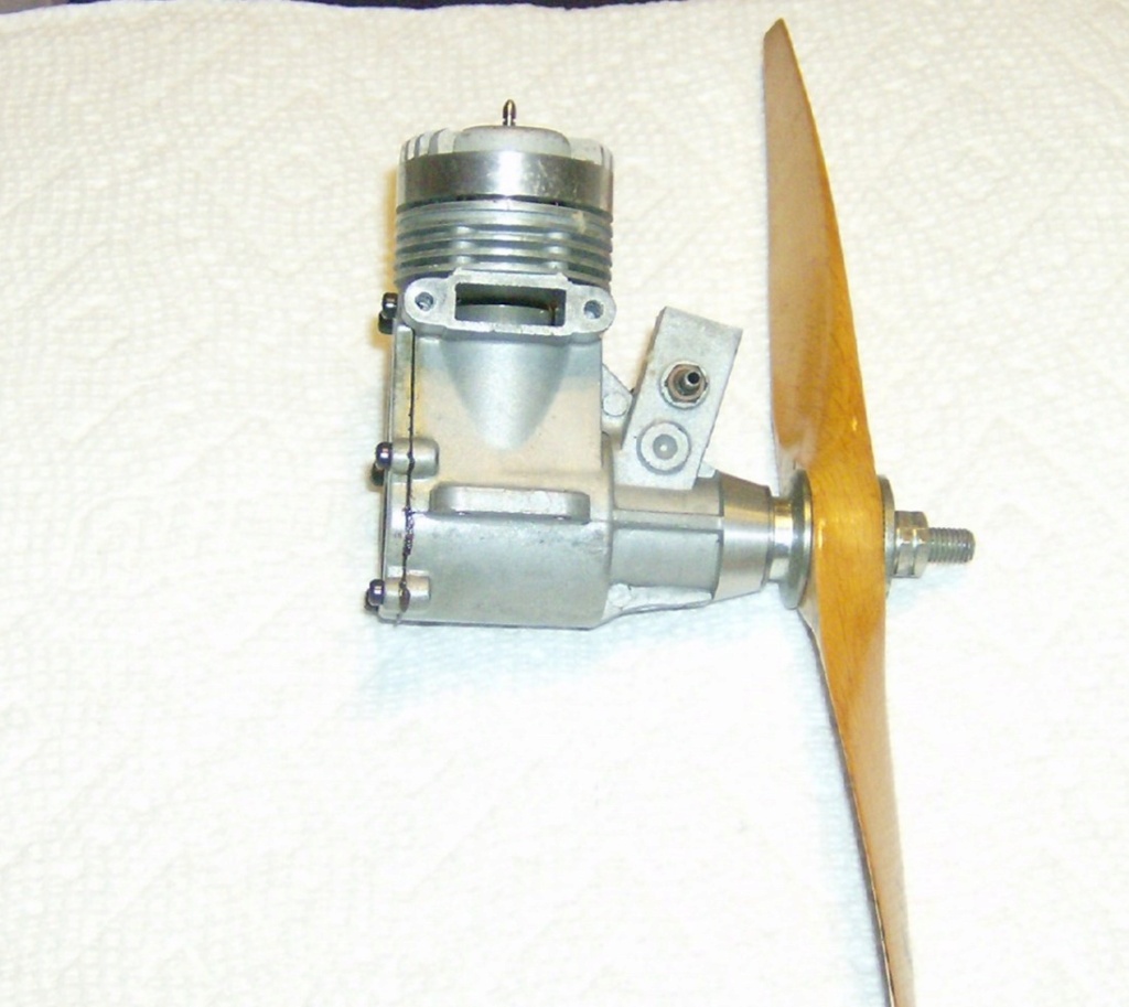

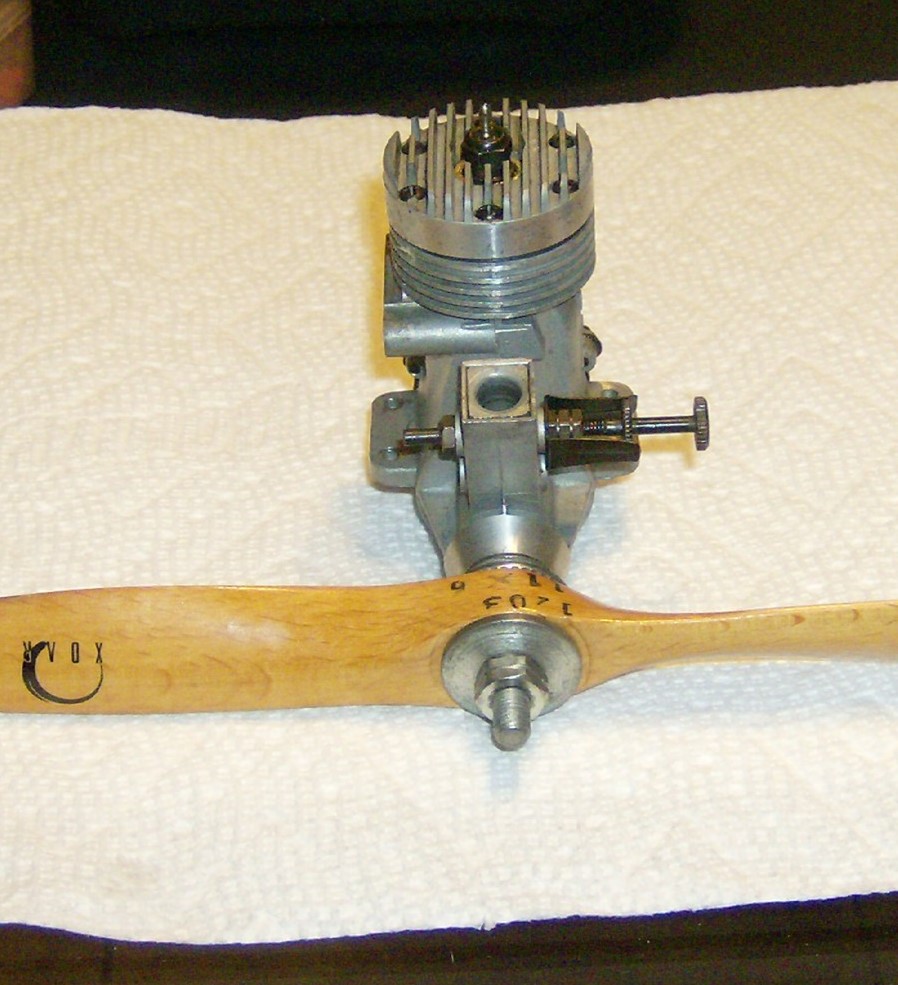

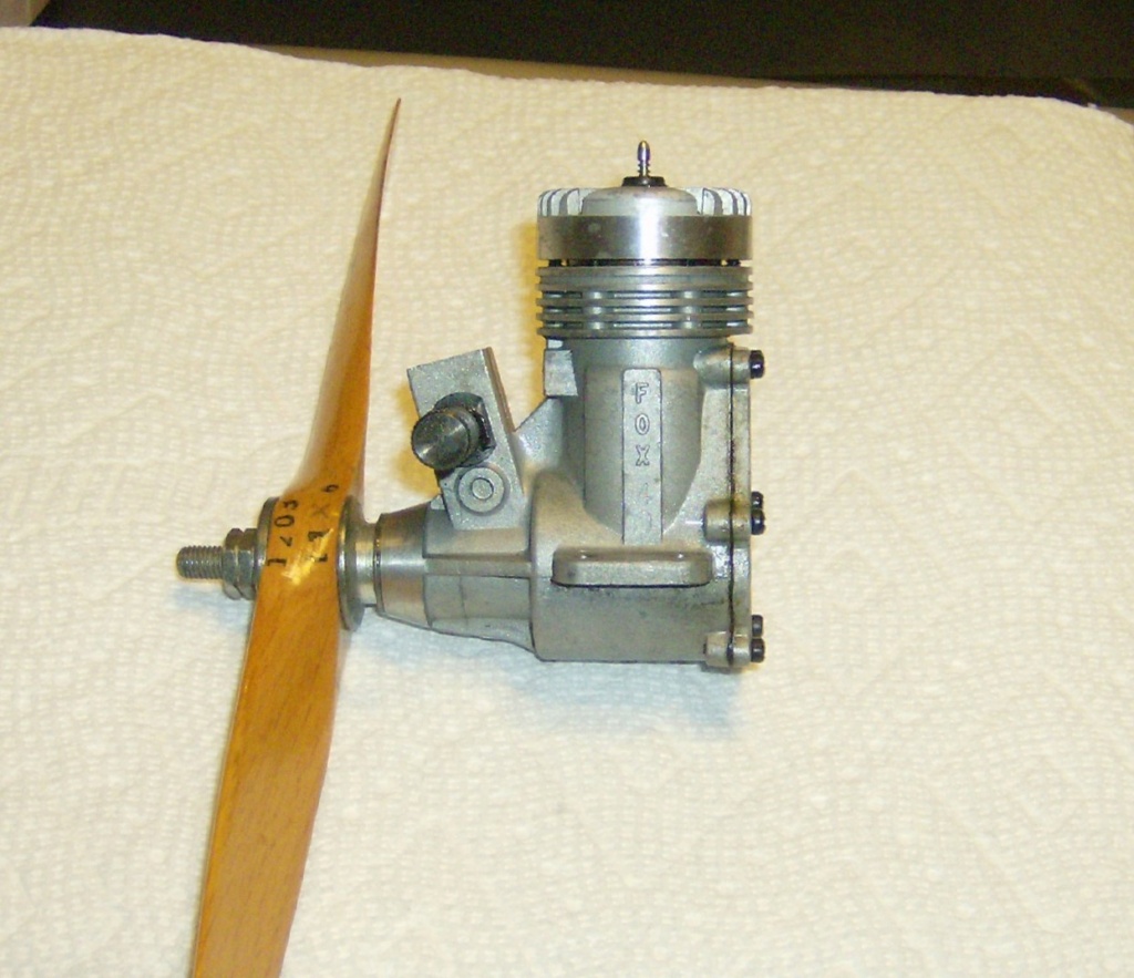

              I have acquired this engine but could not find information on it. what propeller should I use, Is it a Stunt or a rat race engine? All comments appreciated.

Is it a .40?  Or is it a .36 combat special?  The coffin style backplate  and square venturi makes it either a .40 rat race engine or a combat engine of some vintage.  There is a stunt .40 but it doesn't look like this-it's more traditional in design.
I sort of think it's a rat race engine.   Most the combat engines have a slanted glow plug to deal with a battery around the wing leading edge of a combat airplane.

That is a Fox .40 stunt “big case” with a single rear ball bearing and a plain bearing front . I had one with double ball bearings , it wasn’t the easiest engine to tame . Knowing now how to use more appropriate fuel and props it might be a good runner. My first LA .46 spoiled me .
I had a number of MK VI combat specials around the same time, the porting in them was more aggressive . Those engines were ABC construction, most of the stunt .40’s were iron piston engines. The cases were very similar.
Try 10/11/11 fuel and a 11x4 prop for flying. With the iron piston and plain front bearing generous breaking would be advised , maybe with a bit more oil and a smaller prop .

This is the small case .40. Same as the CS motors. I used a few in R/C planes for sport and limited Q-500 racing. Nice motor. Relatively light and there are a bunch of them around. My pal Al worked with one for stunt but could not get the 'perfect' run. The LA is better and easier for stunt but I would not hesitate to use that one with std. Fox muffler for good sport flying!  TS

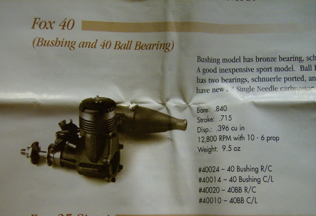

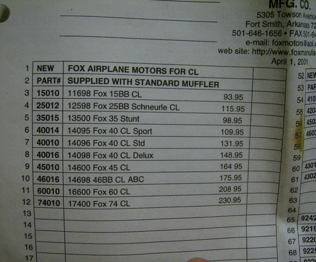

         Thanks for all the comments. I searched thru other boxes of other fox engines that I acquired and found literature that mentions this engine as Pn.40014 Fox.40 CL sport. It has a price list from april 2001 that shows the engine at $109.95 at that time. The engine is a little stiff from being in storage. I heated it with my heat gun and it loosened up,it looks like it was tested on a bench but not used much. I would love to know in which year Issue of stunt news is the article by Lew Woolard that shows the mods to this engine as mentioned by Air Ministry in his reply as I would like to read about it.

      The Sport version was the iron piston/liner version, the Standard was the ringed version, and the Delux was the ABC version and it also came with a polished aluminum spinner and I think some kind of engine mount.  As to Lew's article on the Fox rework I think it was in a 1996 issue. You might even try searching on Stunthanger as it has been discussed several times before. I have one of the sport engines that I have repaired the crash damage that it had and I want to try my hand at it also, and right now I just need the square base venturi. If I can remember the issue I will let you know. I can take a cell phone picture of the article and email that to you. Just something I want to do for fun!!
