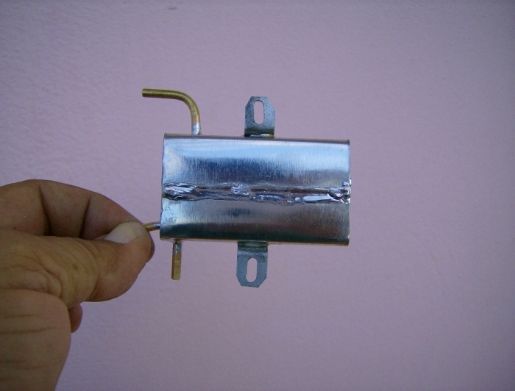

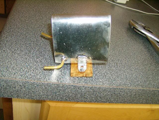

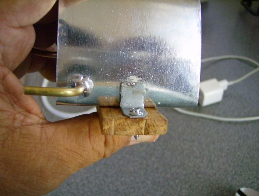

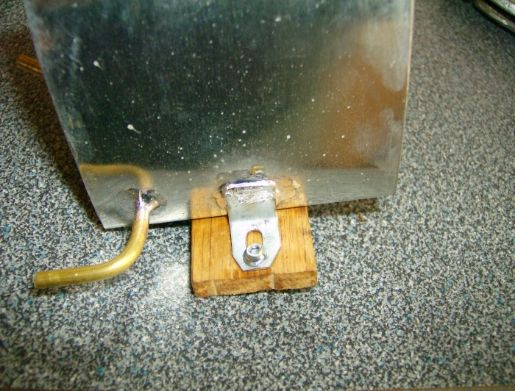

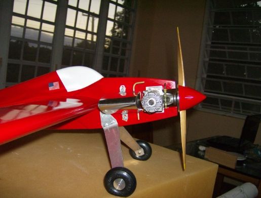

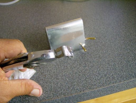

Hello
              I made a tank for my Ringmaster and when it came the time to install mounting brackets I wished for a third hand. I came up with this idea and want to share it. I made the angle brackets and tinned them then I screwed them to a piece of wood with a hex head screw. I also tinned the area of the tank I wanted to solder the bracket to and applied a little bit of flux. Then all I had to do was hold the tank against the bracket and apply heat with the soldering gun. this idea made it a piece of cake.here are some pics.
