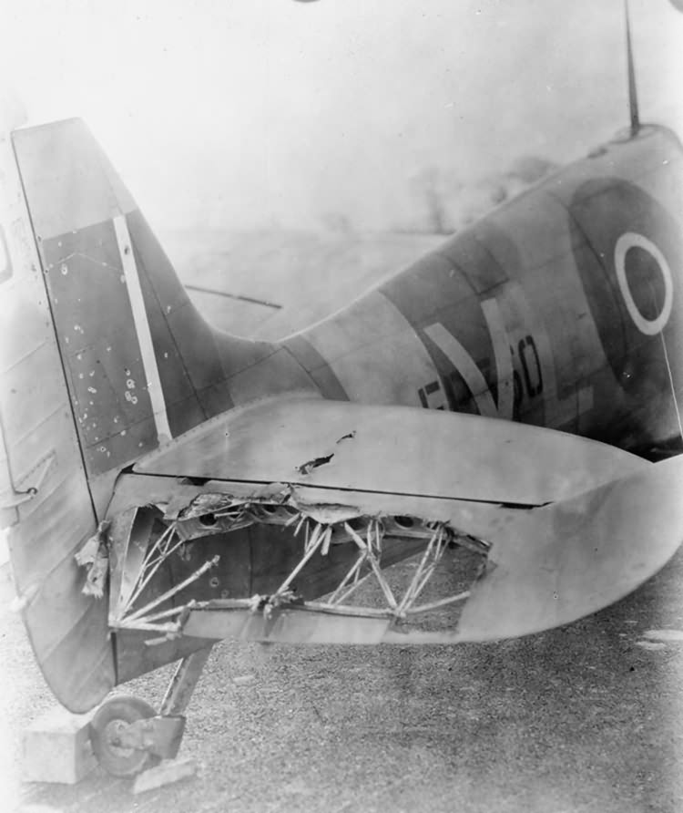

It'd give you a advantage of the built up leading edge as a stiffer structural member too . If you rolled / moulded say a 1/16 sheet front . Bit like this . You can see aft its rather lightweight .
Wether some turkey had walked on the tailplane , top aft . One was a pig , with uncontrolability occuring nose down full wellie way before achiveing the potential speed  .
Eventually they found the rear of the stab skin was depressed / concave spanwise , with the rear area / edge incliened .outward. divergent . Whacking it back flat cured it .
The Moral being ya want accurate airfoil , not wobbly or irregular at the transition Stab to Elevator . Or anywhere else for that matter . The differance being top line to also ran .
They dont seem to worried about air feeding through here , maybe someones got some figures / data , on it . Though SEALING is considered de rigueur on top line F2B
As the STAB. rear is just box & edge ,
The interface or THAT EDGE & the Elevator L E may be the more crucial consideration ? .
Itresting its no flat at all . asin ALL tapered X - section .
