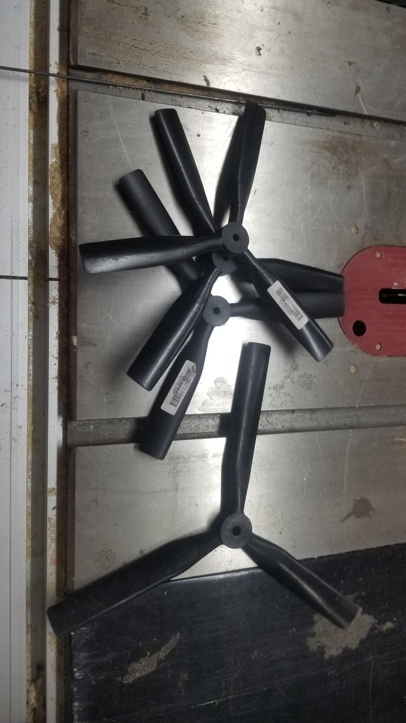

Seems to me this would be somewhat similar to a 11x4 2-Blade, possibly good on the LA .46.  (Then again, I'm often wrong.)  Has anyone tried it?

I saw several of these run on the Evo .36 on their PT-19. Didn't seem particularly special. On the other hand, I saw a Tornado flexi-3 blader fail a year ago on an ST.46. It shed all three blades and in the process did damage to the plane. The blades were scattered all over. At least no one got hurt.
  • Posts: 7550
Re: Evolution 10x4 3-Blade Prop
« Reply #3 on: September 13, 2023, 09:02:33 AM »
  I tried them during my experiments with the ill fated PT-19. I didn't think they were very good at all. I have used the Tornado three blade, Graupner, and the Master Airscrew three blade props, so I have some experience to compare it with. The Evolution prop is heavy, and some one has to explain the blade shape to me. I think that is what hurts this prop. Of all the off the shelf 3 blade props I have tried, the MA line is the most promising. Years ago, some one on the list here persuaded Windsor Propeller to produce their 10-5 three blade if there was enough interest, and there was. It works very well on most .35-.46 engines and can be repitched. Easy on the pocketbook also

" some one has to explain the blade shape to me. "
This is the Evolution 12x4 Alpha 60 3-Blade Propeller. The Evolution Engines Alpha 60 three blade propeller was designed to fly at slow speed while maintaining excellent thrust for climb and aerobatic maneuvers. Engine sizes from 50 to 61 can easily spin this 12x4 three-blade propeller. This prop will control the top speed of your model within a 52 to 70 mph range, which is very practical for training purposes. However the high thrust at low speed is perfect for 3D flying in models designed for maneuvers at slow speed.
They look HEAVY which wouldnt help . But in very thin air , the could , maybe .

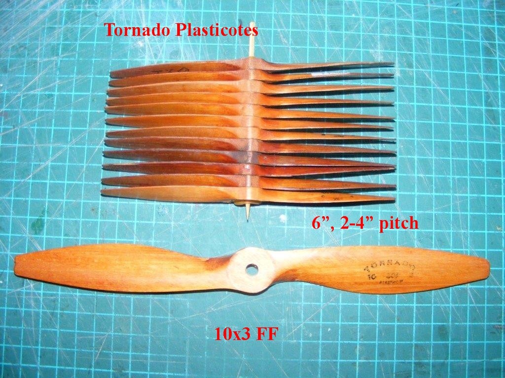

Furtherv Raptures regarding TORNADO Props .
The Old ' PLASTICOTE ' ( I found a picture ) were resin impregnated timber ( so they said ) were a No 1 choice for 1960s Team Race  . Untill the Batels copies in G Fibre came out . My bartels is way undersized !
And , it turns out , the yellow nylon are near identical / indestinguishable so would do rather well for taking a prop mold . there were small hub and later Strong ( big ) hub  . in the 7 x 8's .for .16s , 8x8's for B T/R .
Ive ONE 8x7 plasticote Wood . Heres a picture of someone elses  . Dunno if thats his real name .  ;) BEING AS the 3 blade Tornado blade is indestiguishable , in shape .
Phaa . The blokes got a few other pictures - seeing we're here .
As they were the period top line . . . . thing . Was yellow ones there , but there IS a limit , believe it or not . The Small Hub 7x8 is the ringer for the plasticote .
