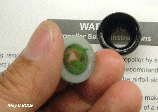

I used both also..    but I've had issue using the Bru-lines ones on a Saito .56. the problem is when it back fires or if it runs backwards.. it would melt the foam.  HB~>
