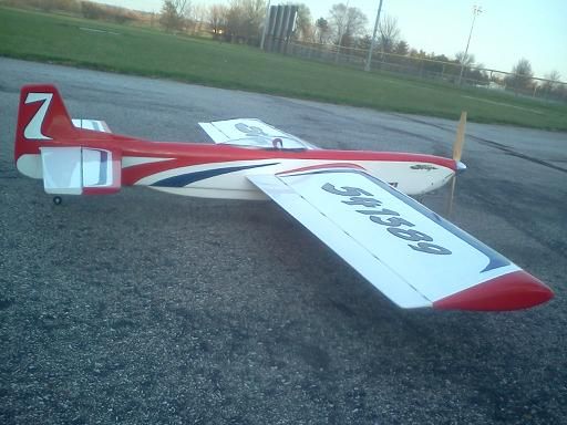

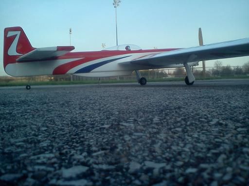

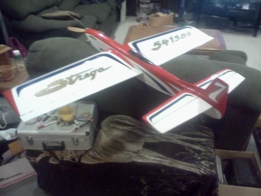

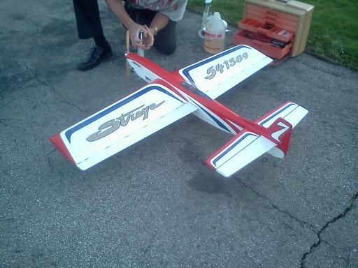

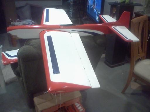

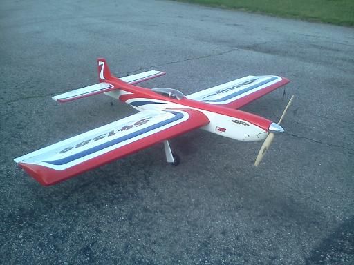

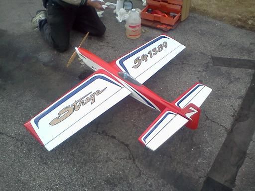

I think the extreme wide angle of the GoPro camera makes it appear that my arm is closer to the prop than it really is.  I am actually well below the prop.  I am very aware of the big 14" props swinging at 8k RPM out there and know the damage they can do.  But good looking out!  Dad's Stiletto is pushing 30 years old and still going strong.  Still looks almost brand new.  Would like to get a video of the Strega after the change as it was a huge difference from the pointed leading edge and now I can compete against the Stiletto and dad but....the bad news...I hit severe wind turbulence last saturday in the horizontal 8, the plane hinged severely and yawed inward lost line tension and since I was on the down-leg of the outside loop of the 8 there was not sufficient time to regain control and the Strega went in full speed nose first  :X  Also bent the crank shaft in the ST 60.  Talk about a sick feeling, I know almost every modeler knows the pain.  So disappointed that I finally got the plane contest ready and now 3 weeks before the first contest its history.
So ordered another Strega from Brodak.  Unfortunately they are completely out of "White" Strega's (and may not get any more), but when I called they said the "Red" Strega was the color I wanted.  I said your sure, its like the picture on the box?  They said yes.  It gets here and its not the picture on the box its hideous red and yellow...So I stripped all the covering off and I am re-covering it with Monokote.  Positive note I was able to round the leading of the wing easily and wont have to worry about the nasty chinakote covering anymore.  When all said and done the wings and stab will look like the ARF "White" Strega but I'll pry make the fuse trim scheme a little more to scale of the real Strega than the ARF Strega's.  Luckily the custom P-51 rudder and wheel pants I made were not damaged in the crash so I can just transfer them over.  Highly doubt it will be ready for Des Moines Contest, slight chance by Topeka.  I'm hoping everything I learned from Strega #1 carries over to Strega #2.  If it does and I don't have to spend a month making 3 min trimming flights over and over it might be ready for Topeka.  But I'm not rushing things if its ready its ready.  If not well we got 20 other planes hanging up down there lol.
The ill-fated Strega

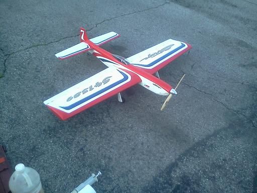

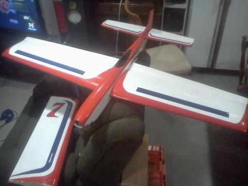

The new ugly Strega
yuck

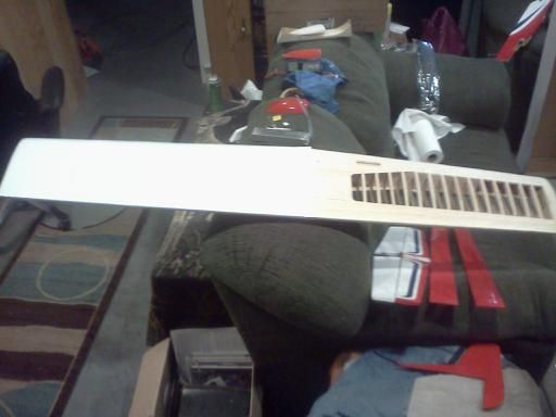

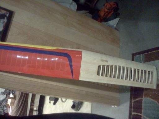

already looks better

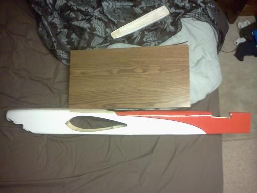

wing half covered in new white monokote

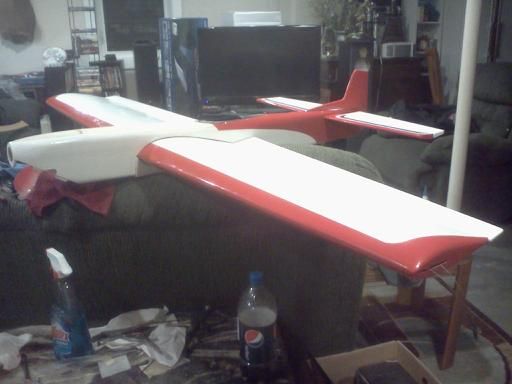

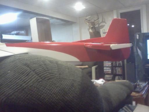

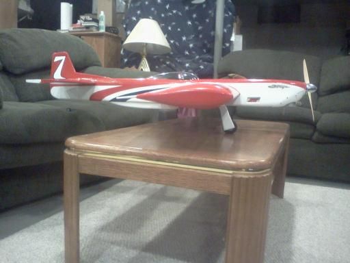

red is done on new wing except for angle section next to fuse
Will post more photos as I go.

Tonight's  progress on the new strega:  Flaps are hinged and installed on the wing and push rod connected.  Started recovering the fuse, and the new fuel tank is plumbed the way I want.  Bed time.
bare fuse
about 1/3 of the way done
I think the deer approves
looking good

Anyways 3 hours of tedious monokote work on the fuse of the new strega...Doesn't look like I accomplished much but looking better every night.  Going to be "a little more" scale than my first Strega on the color scheme.  Curved the red downward on the nose more like the real one rather than upwards like on Strega #1 where I just covered the factory blue.  Also the red comes down a little more on the sides on the fuse rather than just the top.  Bed time.

Tonight's progress: more monokote, hopefully by this friday night I will be ready to epoxy the wing in place.
Lights out
Red done on inside edges of wing next to the fuse both top and bottom, and straight line of blue done top and bottom will work on tapered corners tomorrow.
Blue stripe done on fuse both sides

Okay tonight's progress,  Got the blue on the wings done top and bottom and mounted the fuel tank.  Epoxied the wing into place in the fuse.  Time to go have a serious conversation with my pillow.

Alright its done...should be able to get enough trimming and practice flights before Topeka...But I'll fly something else at Polk City.
Re: 2 more Control Line videos from inside the circle in High Definition
« Reply #42 on: April 20, 2014, 01:07:47 AM »
Whooooo Buddy))))) That looks real nice. Look forward to a video of you flying that Strega.

Alright got the new Strega out tonight for a maiden flight.  Had to tweak the flaps just a bit, add a little tip weight, and move the leadouts a little.  But all in all it flies very nicely.  Looks like everything I learned from the first Strega carried over into this one.  Only thing I couldn't change/fix at the field was the inboard landing gear wire was twisted inward slightly making the plane want to turn in at me while on the takeoff roll lol.   Got that fixed now will hopefully get a couple more flights in tomorrow night and then I'll try out the hard point handle also.  Already flies almost as good as the first Strega on the first night out where it took me a month and 2 gallons of fuel on the first Strega haha.  Maybe just maybe, it will make its debut in Polk City next weekend  #^

 ;D Very nice! Good looking bird and I wish you luck for the whole contest season!   H^^
« Reply #46 on: April 27, 2014, 07:12:13 AM »
 Also....love that flying site ya'll have.
