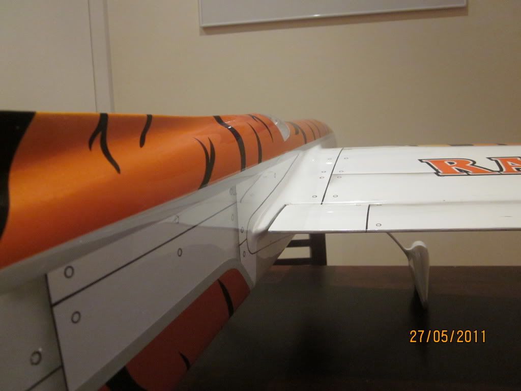

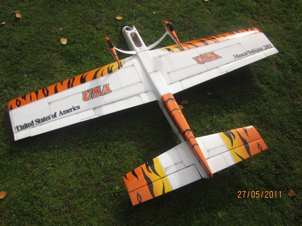

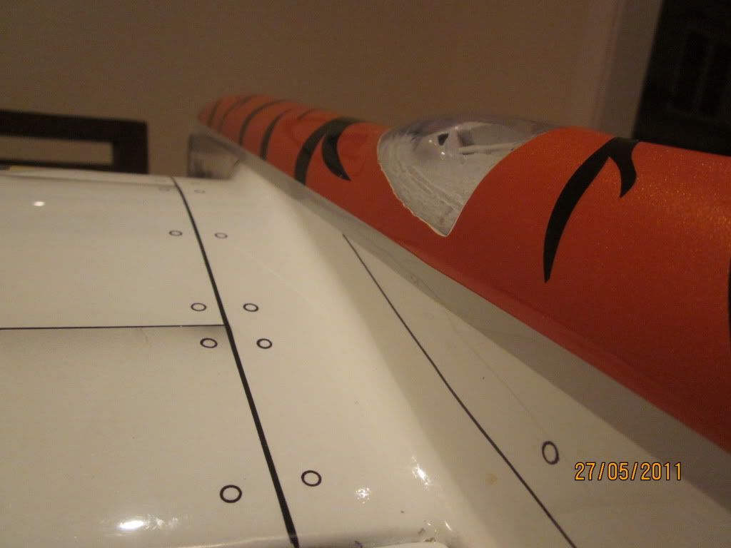

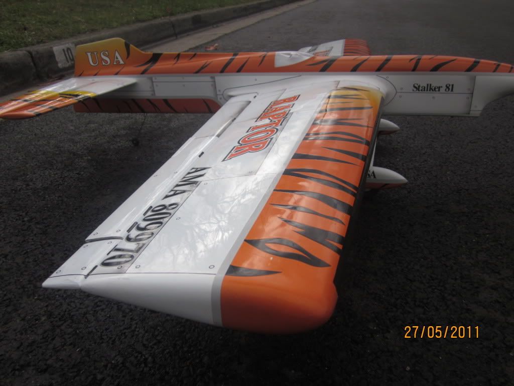

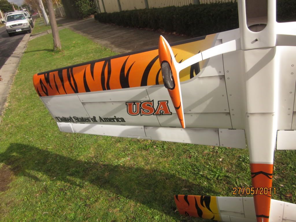

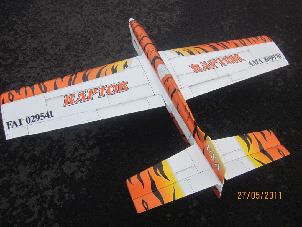

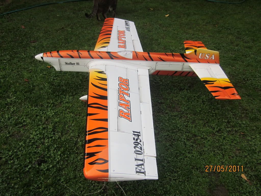

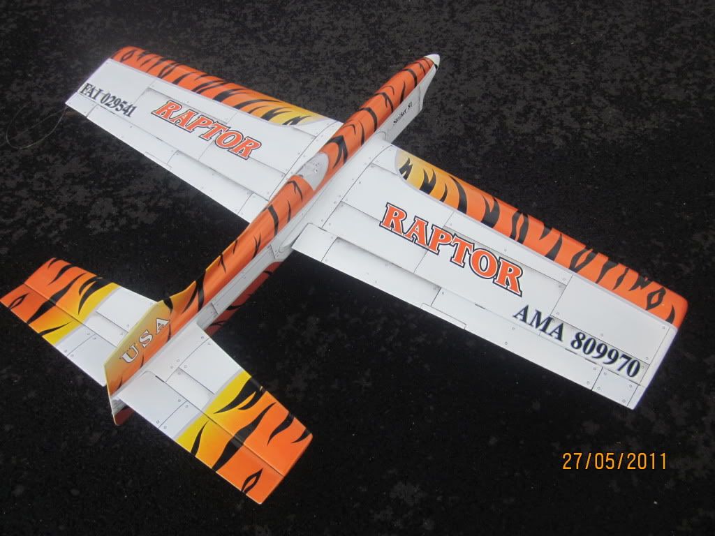

Well its finally finished.
For those who did not see the information posted previously - here is a little synopsis.
Design Concept :
The design of the model is my own set of numbers - however I knew early on that this was going to be the model I was bringing over to compete in the US Nats. There were so many designs I liked the look of - Especially that Thunder gazer It just spoke to me - I couldnt explain why, asthetics are very impressive and it looks very nice in the air. You can add in Bobs 04 Bear to that list - Looking you can see the design cues everywhere
I also tossed around the idea of going towards a Jet style ship much like Pauls Electric American eagle - a very modern take and another design style I love Retro Modern..
Eventually I settled back on the thought of taking my own ship Just modern take - but having it styled and designed around some very successful numbers.
Obviously It had to look good - I also wanted to play around with more side area than previous, something that I've read Brett Buck mention helps his designs, more side area.  -

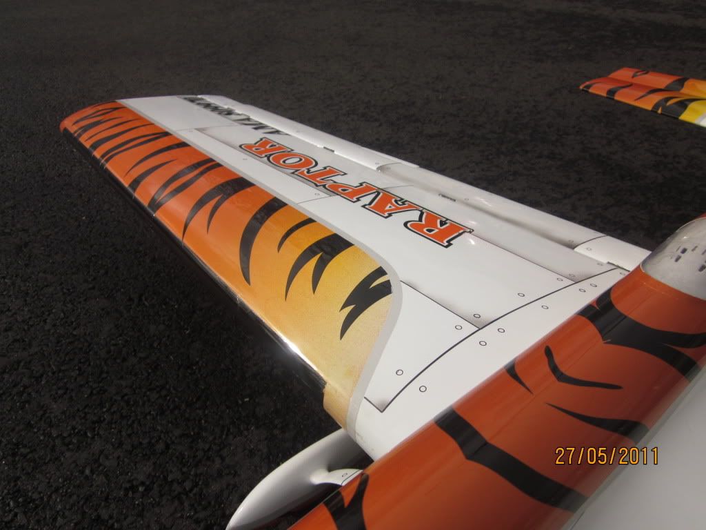

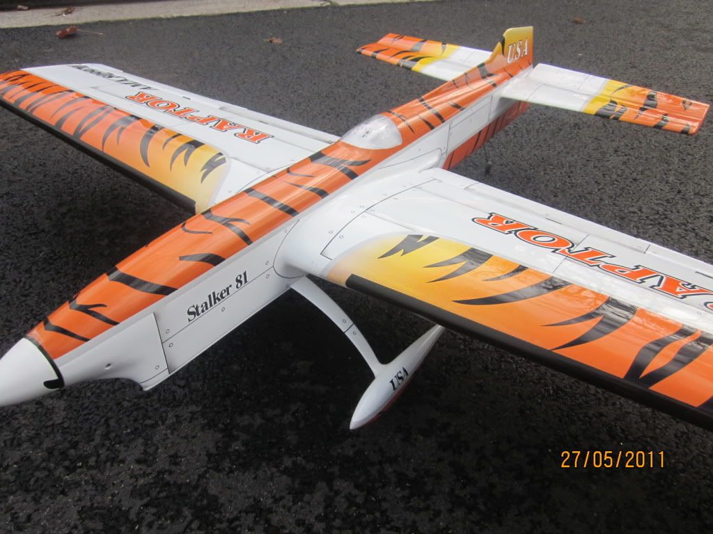

Starting with the wing :
The wing on this specific model is a planiform I have not tried - I used Paul Walkers Miss america mustang wing design from 2004 - but with the flaps identical in size and dimension to the Dave's Thunder Gazer. I should preface that by saying - I do not run quite as much assymetry as the T.G - I run 5/8's instead of 3/4 . Complete personal preferance.
Obviously the Mustang wing has the kick out at the front which I ommited but the Root / Tip and 1/4 chord sweep are all identical.
Wing Area 640 Sq
Tailplane design is similar to what I had built for my last few models but just refining the design .  I again consulted with Dave on the TG design and took many of the design ques. I wouldnt say Copied because I didnt have a copy of te TG plans.. Its not really the same - I just used some cues of thickness and area.. Its probably more closer to the original Trivial Pursuit.
I did get some accurate measurements from the man himself. One of the design features I like to have on all my designs is a very slight swept back hinge Line in the Elevator ( 1/4" ish...).  You can see it on one of the photos if you look hard. Its one of those design features that I have run now for the last few ships - I like how it feels - and how it looks. It does sweep the trailing edge of the Stab back to almost horizontal. Again, its a styling thing..
Fin : I got a copy of the fin only of the T.G and just paid Homage' to it, increased all the proportions, made it more extreme but certainly took all the elements from Dave's Ship. And the Dorsel fin is heighted to aid with the extra side area.
Flaps : Carbon Torque tubes for the flabs and Elevators - Triple carbon layer of Flaps - 5/8 Assymetry. Dual Flap tabs Rush boost tabs. I found I didnt like the feeling of full span flaps I never have - there are various threads about the merits of Full Span. I know the reasons why but Its comes down to feel in the end and i prefer the quicker response rates.

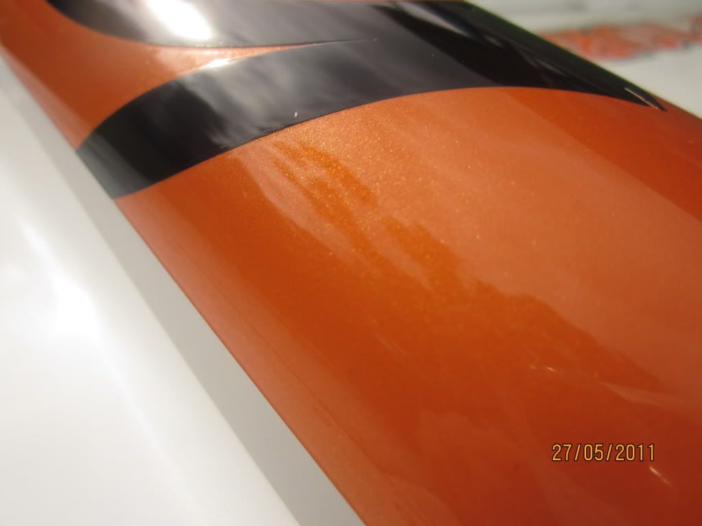

Paint is : Electric Orange Code 6FSE - with 1/2 extra strength orange flake pearl. Its a Ford color - with just a bit more flake. Its interesting looking at the photo's it does change from Dark orange to a vibrant orange depending on light avaliable.  White is Alpine white.
Clear is : PPG painted and prepped completely as PTG recommends.
Weight : I was happy with the build weight, even though I did beef up a few area's for the international flight, and possibility of Muncie Winds. My target weight was always going to be 62 - 63 oz. - I say target - All up flying weight ready to go is 65.2 oz. I hear some people groaning thats too heavy but consider the following : Im running an .81 - and all up weight of my hardware is close to 19 oz.... if I drop the .61 Longstroke in I would save 3 oz and be down to 62 ish.. So its all relative to your engine / Hardward. I will take the extra weight to have more power.
Engine : As started above : Stalker .81 : Rebuilt by Kaz Minato - Custom High Compression Hemi Head made by Oleg.
Brian Eather Undercamber Prop & Tank
Controls: Ball link controls used all throughout. Upon Brett's recommendation Im using the Titanuim threaded inserts inside the carbon pushrob.and Rocket #87 for the first time on this ship.  All Control systems by Kaz minato.   New Carbon/Kevlar undercarts +  carbon wheel pants. Yatsenko Removable Tailwheel.
Hopefully test flights within the next week - I still need to Seal the hingelines, set the Controls, terminate the leadouts, install the engine ect...ect.. 3 more days - Wouldn't have mattered if I finished it 4 weeks ago - Its been awful unflyable weather.
I look forward to seeing everyone In July & Say G'day.
Special Thanks to Randy Powell for listening to me complain about the painting for the last month...... Dave Fitz, PTG and PW for answering my painful questions via email.
Jim at CLC for all the Hardware - Kaz for more Hardware, and everyone who made me feel welcome enough to want to push myself to build something & come back to USA and compete.
Please dont take the bulk of the photo's as self gratification - If any of you saw Lauri Malia's Ship and his final photo's I enjoyed some of the Macro Shots up close - It appeals to my artistic side. Hopefully you all enjoy it also.

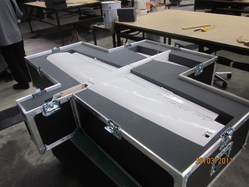

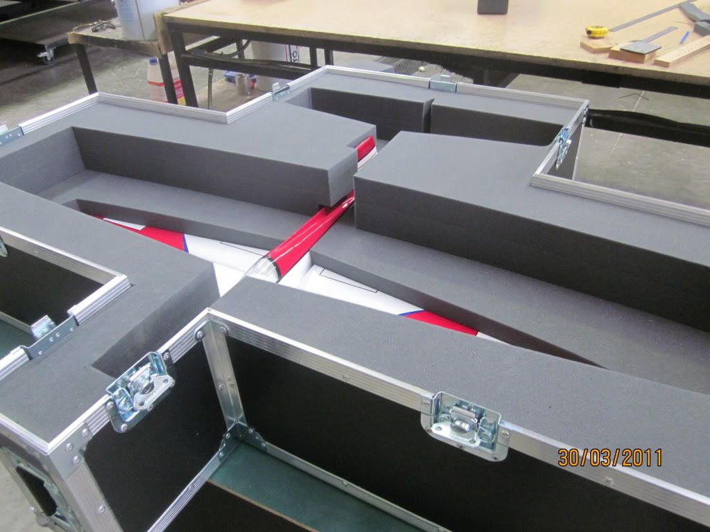

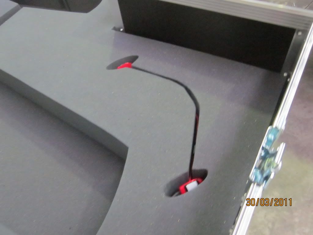

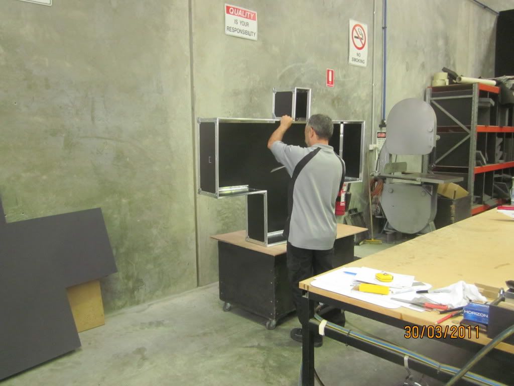

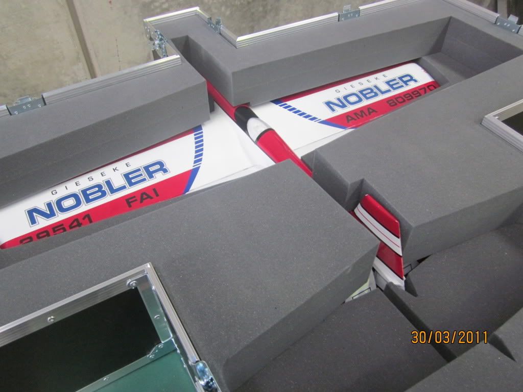

Gday Derek - Hows your's coming along ? I remember you saying it was touch and go ?
Thanks - No your right this isnt Take apart.
I dont mind take aparts but at the time I started - I wasnt confident enough to build one and have it finished to an acceptable level - since then however I've done a T/A so in hindsight maybe I will next time.
Im also bringing over my Classic model - I had no problems in 2004 bringing over a full sized model in a carry case - so this time, I decided I would do the same.
So I need to bring 2 models over in the one box - and still conform to flight regulations - and sizes.
There is a company who are about 45 mins from my house who make custom Flight cases for airline travel. The Bulk of their buisness is Musical instruments, like double base, amplifiers, Chello's ect.. These guys make flight cases out of 7mm Polypropylene which is honey comb - incredible light - and incredible strong.
They CNC Hi density foam to the exact dimensions of whatever is it to be transported. They have all the acceptable dimensions from the airlines and weights. My Box allows for Both the gieseke Nobler and Raptor to be brought over safely. - Very strong - crush resistant, easy to manouver. The box is only 1" wider than the width of the wing - and 1 " at the base. - I plan to use this case again - so its an investment in future trips to USA.  Flush mount recessed handels - Easy to open removable lid. Its fairly light also. 25Kg all up. with both Planes.
The photo of the White model is my test ship - The New one is identical to it in dimensions. So its not white underneath ! ")
I've read horror stories from fellow modellers ,but talking to the road case people, When dealing with a properly built flight case that adhere's to all airline codes and is certified for that ( they supply you with that letter ) Its usually not a problem. - You make it sound like you do this all the time.
As you can see by one of the photo's its only marginally larger that a normal take apart box - What I mean is - its taller - Usually the Take apart boxes with full wing would be the same as the center section of mine - Ive got a tiny jut out for the nose - and only a foot and a bit for the tail to sit in, Not that much bigger 0 you can see one of thes working on it. Its quite manageable.
They also add in any extra parts - like my undercart storage - The way the foam interlocks - the total height of the box is only 13 " the foam supports them being interlocked.

Both planes in one box is awesome.   Looks like a tank could roll over the box an not dent it.  Is Dad's plane being boxed also? H^^

What is the cost for something like that?

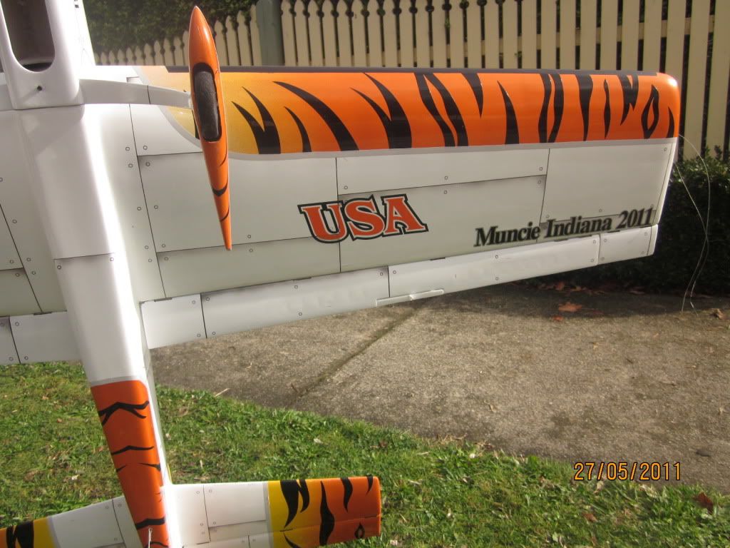

I just noticed that you what looks like two adjustable lead out guides?
Can you explain your thoughts around that please?

In the states a custom box like that is around $1,500. He may not have problems getting to the international gateway airport in the states from down under.
The sticky part will be the domestic carrier legs for any connecting flights. Also getting out of the US may be whole other story, as in recent months Airport security for domestic and international flights within and leaving the US have tightened significantely.
I can say that he is going to incur a pretty heafty baggage charge for any connecting flights and upon departure. 99% of the airlines in the US nail you for any checked baggage for a minimum of $25.00 per checked item. 25KG is 55lbs. That is a minimum of 5 lbs over the maximum that most domestic airlines will accept for a single piece of baggage. So there will also be a excess weight baggagge fee as well as the Checked luggage fee. What the final charge will come depends on the airline.
The checked baggage fee requirements and security measures have mostly been implemented within the past 6 to 8 months. Best to triple check the rules and charges for the American airports and Airlines to avoid any surprises. Not good enough to check only with travel agents and Airlines down under.
We have people travelling all over the world at our company. Recently we had people who upon returning from extended deployments overseass, were charged $50.00 for each checked bag when transfering to a domestic flight. One fellow ended up not being able to board the plane because he had to wait until the company made arrangements with the airline to pay the baggage fees. When they left the country the rules were not yet in place, so no one figured the cost into the travel advances.
Checked baggage fees are not included in the ticket price, they are assessed and payment made during checkin or when clearing through customs and checking in for the domestic legs. What flew last year will almost positively NOT fly this year. I whole heartedly reccommend you tiple check else bring tons of extra cash.

The box built to my specs with time inside the shop with both planes cost me $1,950. - It usually is acirca $1500 for that size.. but square boxes.. I was charged extra for the intricate shape and extra Foam cutting.
So my plane is travelling Buisness Class.
From the people I've spoken to - excess baggage is a toss of the coin - could be $200 USD - heck I'l live with that - I just want to make sure I get over there - Being a professionally built box I was told makes a difference.
There is no internal support  of any kind the high density foam gives it everything it needs.
John : Yes I got them to build a case for his Take apart model also - I worked out a deal and they did HIS box for only $ 600 assembled. - Deal done on the slide..

« Reply #13 on: May 27, 2011, 06:00:54 PM »
Paul : Twin Adjustable leadout positions :
I copied this idea from a fellow Nats champion who has run this for along time, the theory being - when they are side by side you are always biased one leadout further forward or back in relation to where it needs to be.
For example : If you need to " move the leadouts so its 1 3/4" from the CG " you are only taking an average of the 2 points of Up line and Down line.
With this system, you can independant dial in each line location forward or back  - which is something thats limited to a horizontal leadout system approach.- you can also have them BOTH in identical places on the CG location if required.

Paul : It's about having adjustable points that's all.  I would say that I did not come up with that technique.

I haven't worked out the geometry... but couldn't you get a smaller and simpler case with wing tips and tail towards the corners?

How is the masking done for the tiger stripes?   Do you lay it out in a CAD program and then have vinyl masks make,
or is it done with regular narrow masking tape, by hand?

Perti : Both models were Digitally scanned in 3d - layed out over a box in a 3D wireframe, the Box and foam were worked out to accommodate it to maximise everywhere.
The Nobler is also moved as far forward as posible - Il post another photo - so you can see its edged forward within 1 " of the front. This was done to accommodate the other main stunter to sit reverse and the fin drop down.
This box needs to serve 2 MAIN purposes.
Being universal to accomodate other ships in the future - they have a 10 yr warranty.
The company charge you $ 150 to redo the foam inserts - which is nothing.
I also needed to bring 2 planes in the one box so the way the geometry works this was the smallest size avaliable.
Trust me - I was sitting with the guy looking at the 3D model - it is certainly the only way and the smallest way. The computer then mills out the foam to suit. I dont know what your talking about when you reference wouldn't it be smaller - Its no more than 1 inch wider than any section of the plane... Remember there are 2 planes in there.
The rest is trimmed by hand.
Warren :
Its done by computer cut Vinyl.
Offline PerttiMe
I believe you. I still haven't made any calculations or measurements. Just eyeballing the box, I started wondering how it would work out doing as in the rough sketch I am attaching:

But what get's me isn't the 28 flights as much as putting your new baby on a stooge for it's maiden's.
Eeeek! I usually like a human for my initial flight stooge, and a witness to my first flights, heh.
(makes trimming easier too)
Great stuff PJ, model, case & all. Can't wait to see it at the Nat's.
It wouldn't get jammed up in the belt loaders if you did that...(Hopefully not!) VD~
