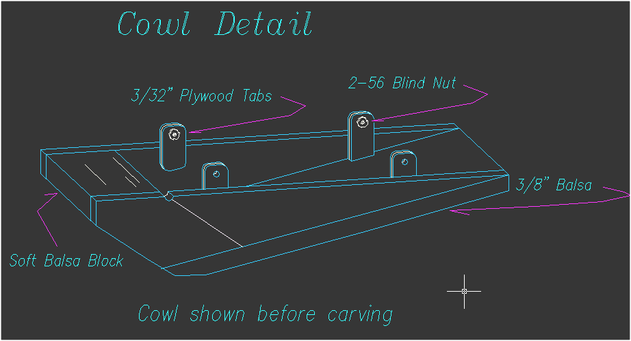

« Reply #4 on: August 12, 2012, 02:35:15 PM »

« Reply #6 on: August 12, 2012, 02:40:13 PM »
Yea Sparky I saw this, but did not really tell me how to carve, and shape. The how to part.

« Reply #8 on: August 12, 2012, 04:13:03 PM »
I remember someone saying use lite ply for the intake.
Between the drawing Sparky posted (from Randy Smith, I believe), and the article in MA by Bob Hunt, you should have the basics. Bolt it on there and carve & sand away anything that you don't like the looks of. If you end up with a gap, either plug it with a hunk of soft balsa, or put a scoop or blister over it. Don't overlook some uses for 1/64" plywood, like Floyd said. I'm attaching some pictures that I have in my files from Igor B. that I think are spot-on for clever design features and logical, inexpensive, and easy construction. Combine features you like, and go for it!
For myself, I like a very practical cowl, such as combining the air inlet and glowplug access. I don't like messing with getting the typical glow ignitor through that darned hole...it will get dinged up.  If you use a remote battery hookup, it's fine, as it still allows you to use the ignitor in case of a wiring problem. You'd probably need to have a structural connection ahead of the cylinder fins...maybe a 3/16" hardwood dowel or a 1/16 x 1/4 carbon stick, etc.  Make sure you can choke the venturi and flip the prop at the same time, preferably both upright and inverted.
The rule of thumb is to have 3 times the outlet area to inlet area. The reason is because the air heats up and expands; the large outlet helps suck air on through. Often not shown well on kit plans, for some reason, but it will vary depending on engine/muffler choice and even fuel used. YMMV.  H^^ Steve
