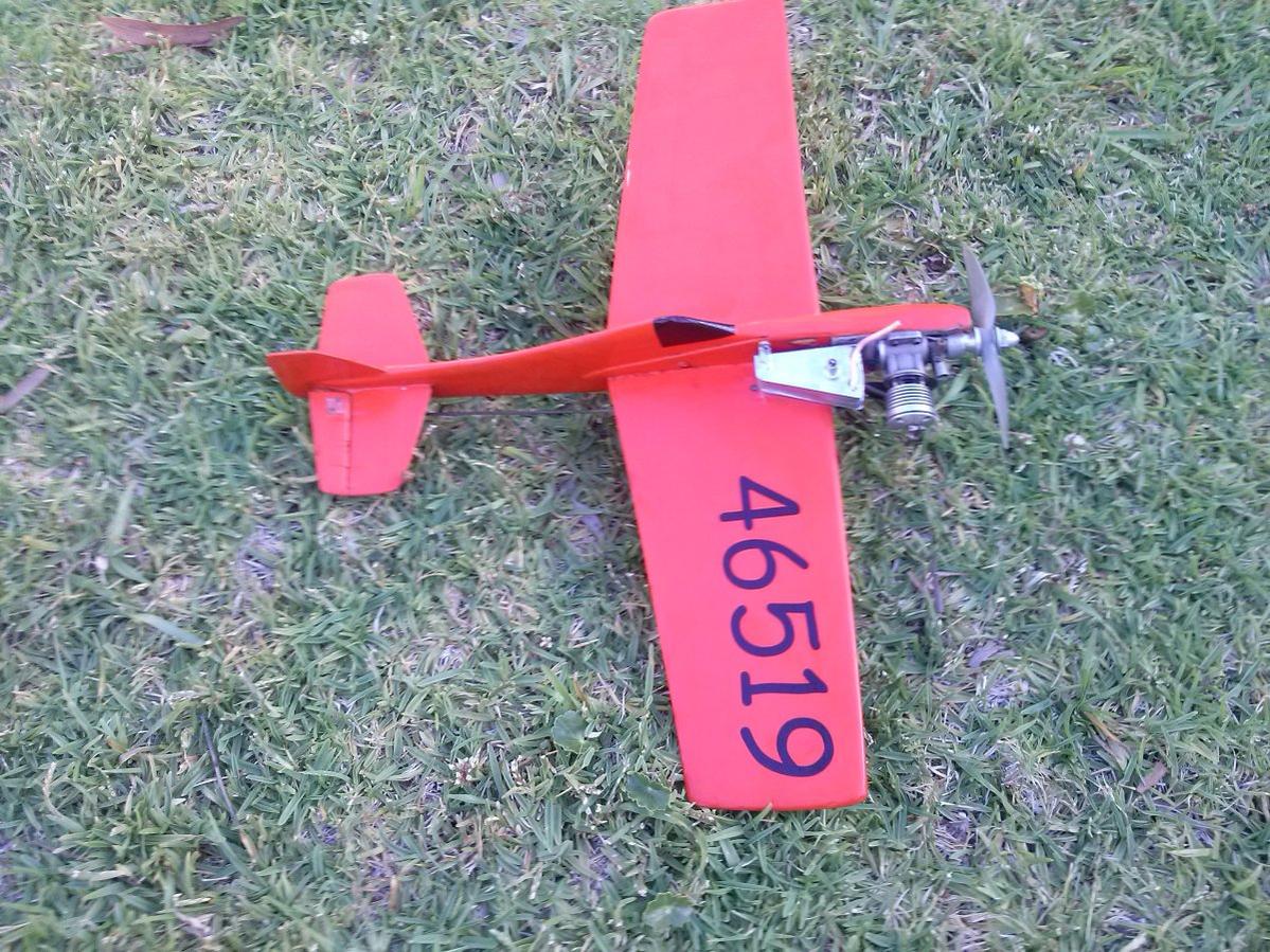

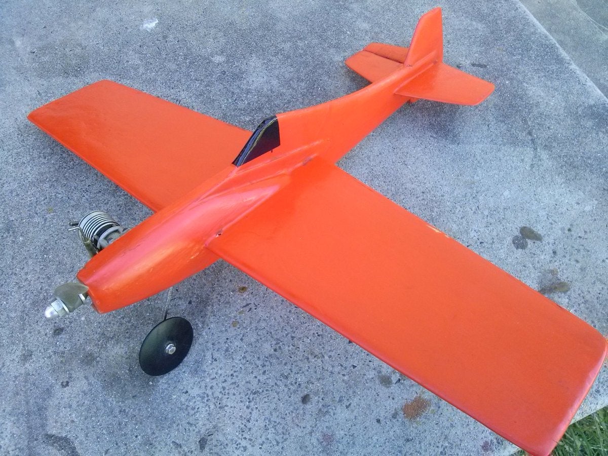

a .09 diseaseil in a .049 glow thing should work . Theres thousands of the . Stunters even , too .
  • Posts: 5249
Re: Suggestions for .09-.15 airplanes.
« Reply #9 on: June 16, 2023, 03:12:12 AM »
Forra . 15 MVVS tooned and ' the Ton ' the splinters the go .  VD~ A 8x4 Taipan prop cut to 7 inch is the go . As 18.000 is where its at .
Goodyears and U K 1/2 A ( 1.5 c.c. !  :o )  might work , TOO .
Took the .012 60 foot lines one day . WHOOPS . 1 1/2 A PAW 74 Shoestring . Flew quite good . Usual screwdriver or two improvised stooge & Dug in Handle .
That an OliverTigerCob . Vrrmmm . Mine was yellow . Tissue . Quite Quick , for a 1.5 sport diesel .
https://www.stunthanger.com/smf/rat-racing-and-team-racing/12a-goodyear-or-mouse-racing/
« Last Edit: June 16, 2023, 03:32:38 AM by Air Ministry . »
  • Posts: 5249
« Reply #10 on: June 16, 2023, 03:38:23 AM »
Heresome Diesel Goodyear from some time back . The Pits !
The Ideas to get 3.5 a lap ( 35 Seconds for Ten , ) outerit . My astounding Miss Dara up Front . Not entirely astounding .
Apparenytly the ' Cut Off ' is best hooked up to the bell crank . When the pushrod fell of there and started flapping about
the  pilot was hitting the down line . All that was lacking was steamers . Quite aerobatic , in the trainer sense , used as that .
They need a bit of fuse reiforcing as catching they skew & the back falls off , cracks , looks marred & untidy . Super Polish Concours is the GO .
20% Nitro in say a OS 20 should see a Ton , no worries .  MVVS D7'd nibble at it , std, if WELL RUN IN . which may be your problem .Lettem Howl . underprop .
