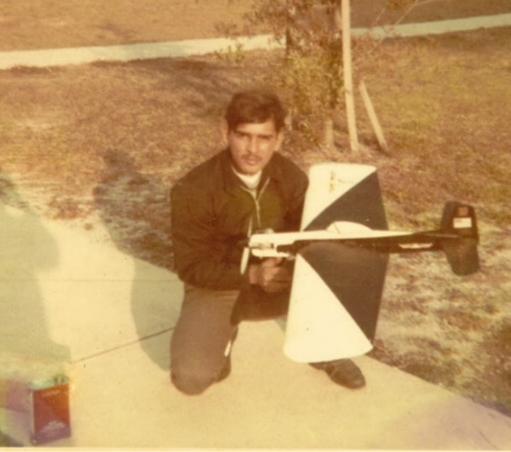

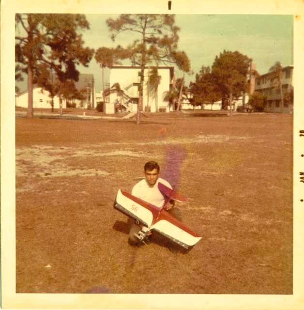

 I will vote for the Flite Streak. I built a few over the years,some as designed and a few like warbirds. I built my first one in Jan 1970 while I was in the Air Force stationed at Mcdill AFB powered with an OS.35 Combat special. Later on I used the wing of the kit and built a P-51 mustang and a Bearcat which I painted with Pactra Aerogloss similar to Al Rabe`s Bearcat Stunter also using the OS.35 Combat Special engine also. I still have the engines. But if I build another one I will go with an OS.25 FP that I have.
                                                                                                                                                                                juan

Juan:
Nice pics and nice looking airplanes! Thanks for sharing!
