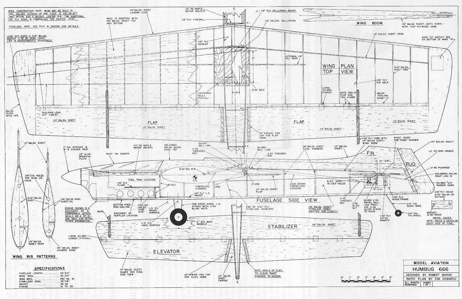

Is there a 60 size stunt-er without flaps
did Bob Barron campaign one in the 90's
thanks
Fred Q

Humbug .
  • Posts: 5253
Re: 60 size no flaps
« Reply #2 on: June 17, 2017, 05:40:11 AM »
maybe ? .appears the big one does have flaps .
http://stunthanger.com/smf/open-forum/great-article-by-bob-hunt-on-the-humbug/msg438740/
So there appear to be a few contradictions .
Filched from : https://www.rcgroups.com/forums/showthread.php?2273786-Vintage-Old-Timer-Plans-After-1960/page5 may be downloadable F. S. .

   Baron had one version of it at the 93 NATs (the orange one in the MA article above), where that well-known member of the Algonquin Round table Windy said it "looks like something you would scoop out a litterbox with"!  It flew OK, but not nearly as well as his more conventional airplanes.

One begs the question of flapless 60 sized ship...Why?   Unless you're just wanting something somewhat more simple and different, it's going to be a big ship anyway, you will probably appreciate the lift and the pretty turn that flaps afford.
Howard Rush's thoughts from 14 years ago probably sum up the whole matter correctly.
Howard Rush:
   You can go flapless if you like, but you will be at a disadvantage. The main reasons for flaps are improved control response and reduced turbulence response, not extra lift.
Howard Rush
http://www.clstunt.com/htdocs/dc/dcboard.php?az=show_topic&forum=103&topic_id=59451&mesg_id=59451&page=369

Still have that Humbug hanging in my 3rd bedroom as wall art. It is surprisingly well finished and still in great shape. The stab is huge as you can see by my yardstick laying behind it. I bought it from Tom Dixon at a KOI shortly after Bob passed.
Of the large Humbugs, I think this was the last and best of the bunch, and it flys great. The plane fly's very conventionally, which might make some people scratch their heads. It was originally set up for an FSR, and it was under-powered. He switched it over to a ST60 and it was pretty good. I had a ST56 V case in it (I have no idea why, I had plenty of ST60's at the time, but it seemed like a good idea at the time? I plead temporary insanity)
I may revisit the plane and stick a fresh ABC ST60 in it, or my Casalles Randy Aero ST 67 in it, because the only real problem I seem to remember is that it was always searching for a little more power. The weight is fine, it is just a huge draggy plane. The wing is basically a Patternmaster wing with the flaps permanently attached to the trailing edge.
I have a side exhaust PA61, but the dimensions aren't even remotely close, which is too bad, because I bet that would be THE answer for this plane.
PS: Owen Richards who sadly has long since passed, was a local club member and had the Orange Humbug for a while, on loan from Owens son who lives in Georgia. Owen never warmed up to that plane. He tried trimming it 9 ways to Sunday... pinned the flaps, with flaps, moved the CG around, just never got it to turn a real corner.
