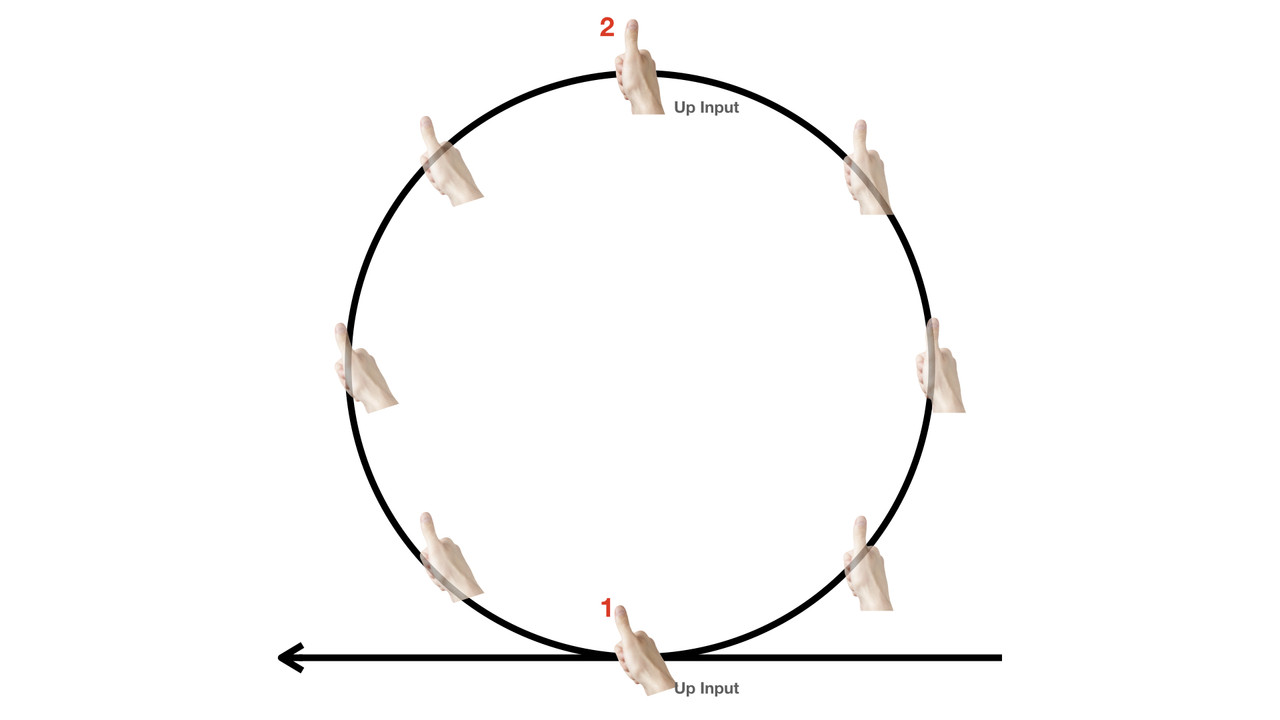

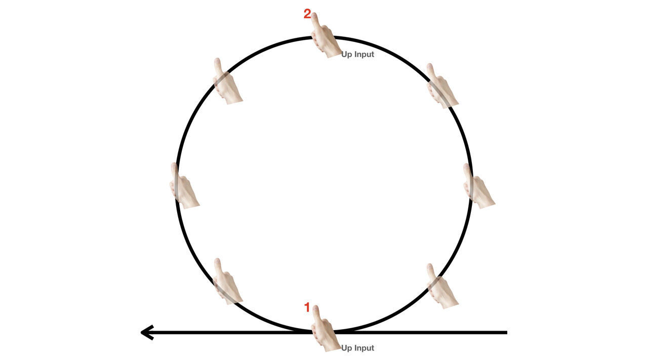

Hi all,
As I’m progressing to learn more manuevers now, I also wonder how I can make my inside loop better. As of today, I can do the consecutive inside loops with confidence, but still lacking consistency on its shape & size.
I know the basic idea to do an inside loop is to put an up control at the entry, let the plane to climb to the top of the loop and then put anoter up control to obtain round inside loop until the plane recovers to level flight at the same altitude that it entered the loop.
I’ve been trying to fly like that basic idea as well as learning from another videos on YouTube, and I’ve come accross with this question: Is the handle position (the way I hold it either it’s vertical or a slightly tilted) going to make any difference?
So, here I have sketched some scenarios I’ve had in my mind now:
A. Vertical — all the way from entry to exit
B. Slightly Tilted — all the way from entry to exit
C. Combination
or
Any thoughts on this? Is it also applicable in another manuevers?
Looking forward to hearing more ideas from you.
Thank you!
Best,
Kafin

I can't speak for others but for me it is vertical from takeoff to landing except for the Reverse Wingover.  There may be some slight tilting here and there but not much and not intentional.  Keep it vertical and relax or tighten as needed to make the loops round.  "As Needed" varies with wind and the plane you are flying.
The only place there is any rolling of the handle is in the reverse wingover.  The physics of the flight path forces you to roll your forearm

I suggest #1, but would also note that if you don't follow the model with your arm/wrist/hand/handle through all the maneuvers, the control input tends to go away, in case that needs saying. Tilting the hand/handle isn't a good idea, so avoid learning bad habits. It's harder to un-learn than avoid bad habits from the start.
Also, avoid putting your thumb on top of the handle to give "extra down control" on outsides. If the model turns equally inside/outside (it better...if it doesn't, adjust THE AIRPLANE to make it), it won't help and I consider it a bad habit. Do NOT bias the controls or handle. Always, always, always, fix what's causing the problem, rather than doing some "work around" stuff.  n1  y1  LL~ Steve

  I don't think you should tilt it at all, but very small tilts won't hurt anything.
   As you go through maneuvers, you should try to follow the airplane movement, so that if you drew a line from the center of your chest, through the handle and then to the airplane, it would be a straight line. That will make the control motion consistent throughout.
     I would note, however, that you might consider that the control effort is not going to be constant throughout the loop, at least not if it is round. It will take more motion/control pressure at the bottom than the top, because you are fighting gravity at the bottom and gravity is helping you at the top. So you will have to vary the control input throughout the loop. Following the maneuver with your hand as suggested will make it consistent, but it will not be constant.
     I think it helps to think of it as control pressure, rather than an angle or handle displacement.

     OK, this again - "dueling experts".
   In fact, I don't think it is a good idea to just "wing it", and I would note that at least Paul has generally excellent overall posture and arm positions, and having flown his airplanes, they are not wildly different from anyone else's (except for *being in excellent trim*, which only reinforces my point) and certainly do not need any additional "help". Also, that both Igor and Paul learned to fly at a high level in the era where the airplanes needed a lot of help, which is where these sorts of things start - because you *had to* do them to get through.
   If you are just starting, I think it greatly helps you to have not developed these tendencies, since if you use properly-set up modern equipment, you patently don't have to do this sort of stuff any more, and while it can be overcome, why set up a problem that then you have to fight later?
    So, my advice stands, stand up straight,  hold your head straight, and frame the maneuvers in front of you. Follow the maneuvers with your arm, hold it in a position that don't change the control input/pressure as you do the maneuvers, and I think it is a lot easier. Of course, if there is some problem, then, do what you have to, but then go back and figure out why you had a problem and take emergency actions to deal with it, change something so you don't have to.
    Again, this is my best advice from watching all this stuff for decades. I think it will greatly simplify the process of learning to fly stunt and have abundant examples to point to.    No one has to follow it, it is just advice.
Brett, just wanna share a quick update.
I tried this suggestion this morning on my weekly practice session, voila, my inside loop is getting way better!
Thank you so much!
