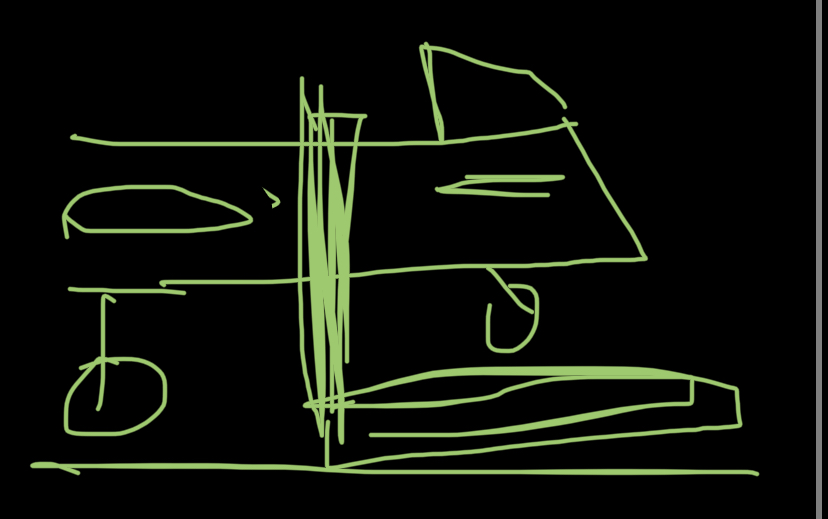

Hi all, this morning I tried to fly my Vector by myself using the “goal posts” stooge. By using this stooge, it’s very likely for the plane to have a slight “bump” upon the release due to the position of its tail wheel to be on the top of the stooge platform. (Please see the attached sketch)
And today, I wasn’t lucky, the “bump” had caused the nose of my Vector to be pointing down and yes, the prop was hitting the asphalt and it got cut. Other than the prop cut, how bad could the damage be? Especially to the airframe. Any similar experience?

I too have a stooge like that, only with a tail wheel cut out so no bump..Make a grove for the tail wheel, should cure the bump problem. D>K

 Do as Ty suggests and cut a slot in your stooge plate for the tail wheel. I have been using this type of stooge for over 15 years with absolutely no problems at all. Use a heavy, (65 pound plus), braided fishing line, (Spectra), for your stooge release line since it has very little stretch.
