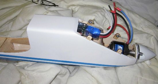

I think that my Legacy will be converted soon , The plane is light and I need just 4:30 in flite time .
My 4S batterys will be enough
