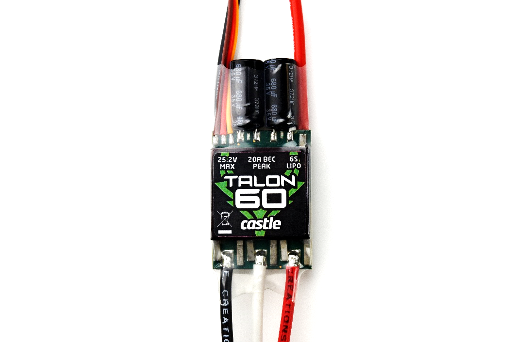

For those that might be curious.  The Talon 60 is now in production and available.  Has all of the governor functions and programming of the Ice and Edge esc's, just no data-logging. The Talon 60 can handle 6S / 25.2V, 60 amps.  The BEC is rated for 20 amps peak and 8 amps continuous.
http://www.castlecreations.com/en/talon-60-6s-25-2v-60-amp-esc-with-20-amp-bec-010-0163-00
This is a good option for anyone with a medium/large airplane wanting to get into a Hubin timer compatable system for a reasonable cost.  Looks like you can get into one of these for about $60.00 from various sources.  I'm excited to try one out later this spring.
