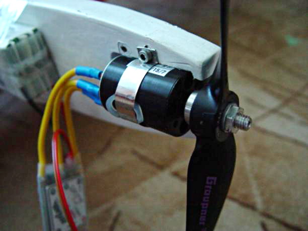

Mike, I affraid tne Mega 16/7/12 will not last long time at 10A. Better chice will be longer version 16/15/7. I used it on .15 sized model with 3 cells and electric prop 9x6 (thin "APC" like tips so it effectively smaller than 9"), but it is also not the best choice. But in any case it is easy to install to such model with 3x Kokam 2000 converted from profile .15 IC model.
here is how I did it:
http://www.controlline.sk/oldweb/modely/elektro_burger1/electr4.jpg
http://www.controlline.sk/oldweb/modely/elektro_burger1/electr1.jpg
I tried to find some setup, but the best I found is better for bigger model - motor PJS 1400 3 cells 2200 20c cells. It is in larger moder 800g heavy (29oz) span 1200mm (47") folding prop 10 x 6 also with thin tips
