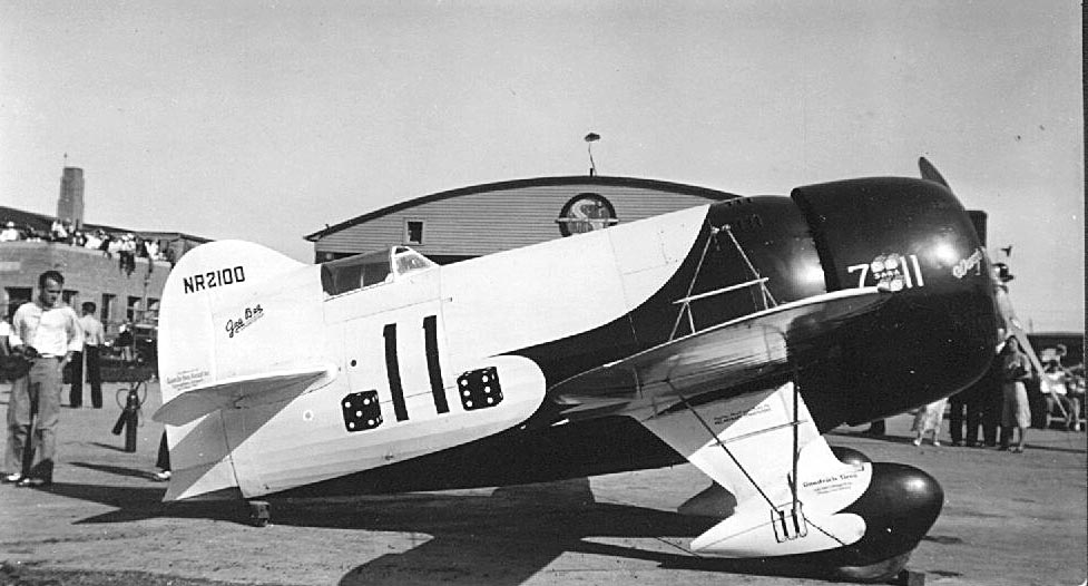

as I recall reading, this phenomenum is why speed record airplanes, supermarine and Macci come to mind, are all seaplanes,, nice long runways to work with,, otherwise the loss afforded by big ugle floats would be a detriment not worth it,,

Hey, isn't that David Fitzgerald standing there behind that Gee Bee? Probably a replica...the Gee Bee, I mean!  :o Steve
What was that about floats .  n1 :-X

This and other Gee Bee photos, way back when I was a kid, confused me about what I THOUGHT I KNEW about propellers
Sorry to drag up this old thread
But I am trying to re-educate myself all about propellers now that I have many different 2 and 3 bladed props to play with for all the various .20 /.25 /.36 / 40/ .46 / .52 I am going to use on a few bucket list models
Way back as a kid... there was a nut case slightly older than me, who proved to all of us unbelievers, that a brick could fly with a big enough motor.... then came a lot of real  stupid experiments making all sorts of crap zoom around in a semi controlled flight circular path ( My belief being centripetal force was more at play than any true aerodynamics)
Just for discussion ...as a kid I got the idea from the Gee Bee that ONLY the props TIPS did ANY work
These racers were just like today's models.  In the absence of GEAR REDUCTION, the props ran at engine RPM.  They, like us, knew that the props were too small, but they couldn't do anything about it.  Later on, props were geared-down 3 or 4-to-1.  The last two major production planes without gears were the Beechcraft 17 & 18, which look like models because the tiny props.  They Bearcat & Corsair are examples of what planes look like with high power and geared props.
  Huh?  I *could* run a prop 25% larger if I wanted, and PA75 will turn a *16"* prop with no real problem if you wanted to.  You don't want to because large props hurt the performance.
   Larger props at low RPM are much more efficient than small props, and that is *poison* if you are putting a PA75 on a 625 square inch airplane.
