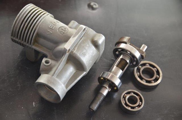

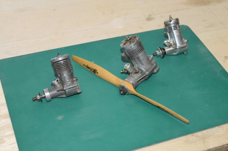

I have 3 Veco .45's. All blueprinted by Clarence Lee (Mr.Veco) He is still in business and will  check out your engine and check the correct timing for stunt use  for about $25.00. Also he can make the 2 side exhaust plugs. Send it to:  Clarence Lee  10112  Woodward avenue Sunland  Calif. 91040   y1

Three years ago, my buddy Henk took up restoring Louis van den Hout's Spider, the last of his Olympus line.
With the plane there were 2 Veco .45 engines that were restored by Erik Janssen.
Henk and I did the test flying and setting up the engine. An entirely different machine from those I remembered from my IC days.
Indeed, very tight to begin with it took ages for it to begin loosening up, but finally it behaved nicely.
Had to fiddle with the needle as there was an airleak at the threads. A piece of fuel line corrected that as a temporary solution.
Then it turned out to be a perfect engine, good response at the needle and very good 2-4-2 switching.
Louis was over the moon when he got his Spider back in flying condition.
