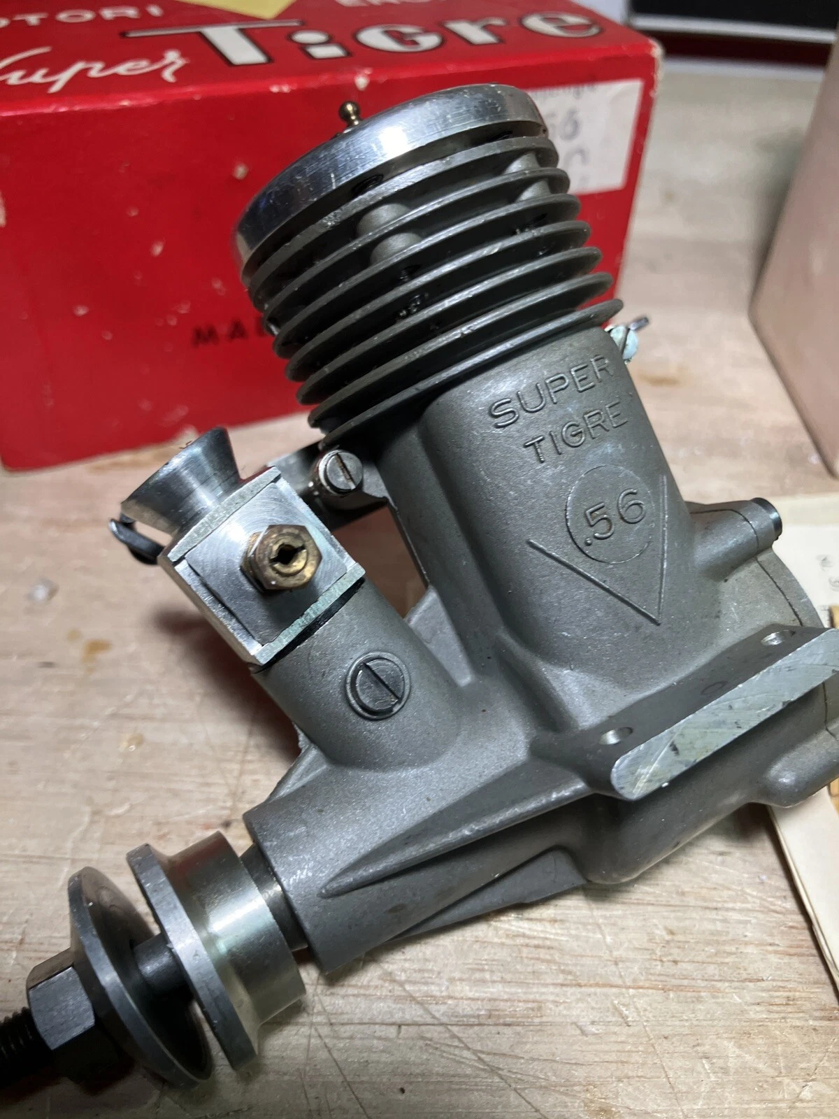

Thisisabout where ital STARTED . Plain Bearing . Ball Race the  bearing housing makes the case otherwise .
these dogs had lapped pistons initailly and overheated . Thus a RINGED , Finned Head , ' 56 ' ( wassa 51 too & 45 )
Plain Bearing ' 56 ' is pretty much what a Kolesnikov KA 9 was , and its double Star 55 clone ? perhaps ? .
Knotte the PLAIN BEARING . for lightyness , Boll Rices give higher r.p.m. with less drag . However . The ST 60 were ALL Ball Race .
unfortunately the plain bearing ( and ball race ) 56 are a differant head bolt p.c.d. to the . 60 . Although the same stroke  .
1 m.m. down on the bore . 23 x 22 Vs, 24 x 22  m.m. .
