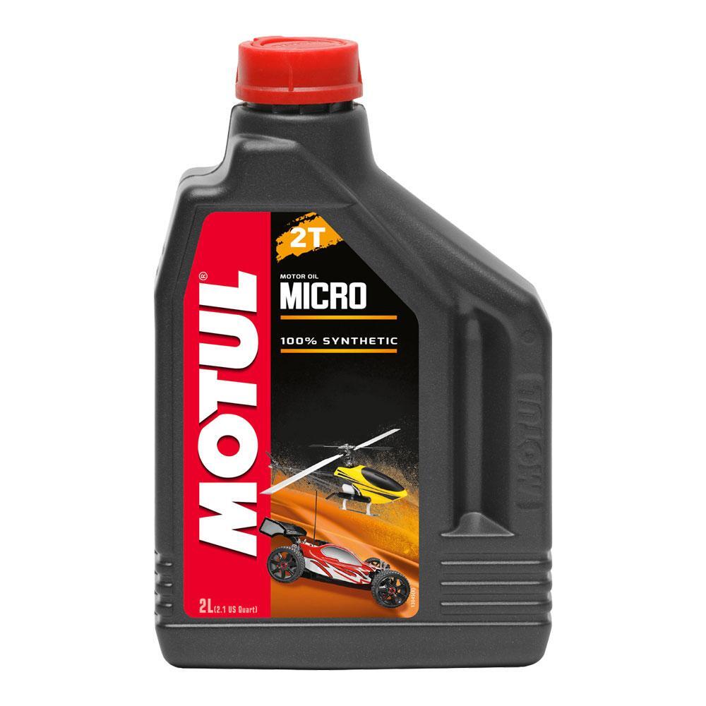

Somebody says you need MOTUL to get the Retro Discoveries to run smooth . 2T . Just looked and theyve FIVE 2 stroke oils .  :(

Only one is recommended for Methanol mixing; Motul Micro 2T. Works great

I’m not sure if Motul is readily available here in New Zealand. If I can find it I’ll give it a try.

Yep , sorry about the spelling .
Motorcycle Shops might carry it .

Try your local motorcycle shop
https://motul.co.nz/product/micro-2t-12x2l/

« Reply #13 on: September 22, 2020, 07:03:03 AM »
I can supply a case if you want.
Brian

« Reply #14 on: December 04, 2020, 08:36:21 PM »
This is the one . Only $ 50 per litre !
DONT try the 800 .  >:(
Lubricant specially formulated for 2 stroke engine model vehicles (cars, boats, planes etc)
Miscible with Nitromethane, Methanol/Ether

« Reply #15 on: December 04, 2020, 11:13:31 PM »
   I was going to suggest going to the bank & make sure your account is high before you buy Motul. I used it a while back in my motorcycle & it was real pricey.

« Reply #16 on: December 05, 2020, 04:57:42 AM »
Hi.
Motul Micro is sold ONLY in 2 liter bottle, I don't know where you read the price but I can assume it refers to the packaging so the price per liter should be half the price.  You can check the link given in answer # 12
