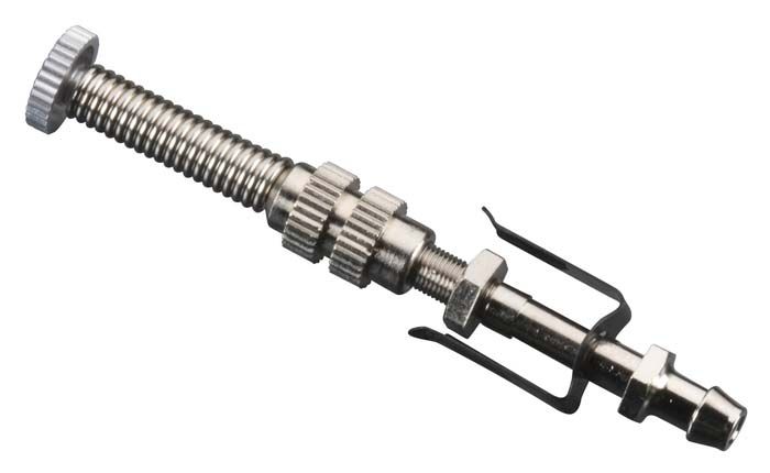

            I have just been given an OS Max 15 S in quite reasonable condition. It is complete with the venture restrictor, but no NVA . Anyone happen to know the diameter of the FP 15 NVA assembly that Tower is selling? Looks as though it might fit, rough diameter of the hole in the venturi is approx. 0.33 inch diameter.

0.135" is a very funny number—particularly when comparing metric and imperial measurements. 3.5mm is 0.138"—the OD of the current OS factory NVA for the FP 20–40 and the LA46 engines.
If I remember correctly, the standard OS NVA for the FP 15 was 3mm, 0.118" OD. However, it may have been 0.125"—3.2mm. It's some time since I measured it.
Re: OS Max 15
« Reply #5 on: December 08, 2013, 09:21:48 PM »
The battery in my caliper is dead, but I can say with certainty the Max 15 and FP 15 used different NVAs.  I'm pretty sure the 15 FP spray bar is the same diameter as the 20-40FP-S spray bar, with the part through the venturi turned thinner.  The Max 15 spray bar is a constant diameter.  Without actually trying to install a 15 FP needle in a Max 15, I would expect it won't fit without drilling the case/venturi.

The FP 15 NVA, Part No. 2171 1000, measures 0.123" OD and is parallel. As far as I know, the only FP NVA that's turned down across the venturi opeining is the FP 10 part which I think was taken from the 10 FSR.
Re: OS Max 15
« Reply #7 on: December 09, 2013, 06:35:16 PM »
Weird.  The 15FP-S spray bar in my spare parts bin is stepped, as is the one pictured on Towers website.  Maybe they've changed since...
Sorry, the picture is very small because it is not mine.
There is a very little step.
Aki

I just rechecked the diameter of the hole in the crankcase and it is indeed .135" Maybe the restrictor hole is a little smaller, but the restrictor is stuck tight and will need some gentle persuasion to rotate it. At the moment it is partially aligned with the crankcase hole, so I can't measure it.
0.135" rings a bell somewhere, maybe it was on Len Neumann's site where he is selling NVAs. Yes! I just checked there and he is selling 0.135" diameter OS NVA assemblies suitable for FP 20 - 40 engines. This is odd as I would expect that the nearer NVA would be for the FP 15 which Tower carries but gives no dimensions for!
  Here was I thinking it was a simple question! Maybe it is, but the answer seems complicated. I will loosen up the venture restrictor and check that the FP20 venturi fits. I never gave it a thought that it would. I assumed the NVA would have a smaller diameter. If it fits then I will give it a run or two and see how it behaves.

I got around to fitting the FP20 NVA, so yes it did fit without any mods and yes it worked fine on the test stand. Seems odd, but there you are another old engine saved for reuse!
