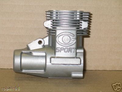

Might maa differance on restarts on a hot day . ring / abc .
Pays to shave the side . The bit with ' SPORT ' here . Solid on G 51 .
Take the lot back level with the G , polish on wet & dry . Custom .
so the %#*^ Screwdriver or whatever isnt disrupted mounting it .
