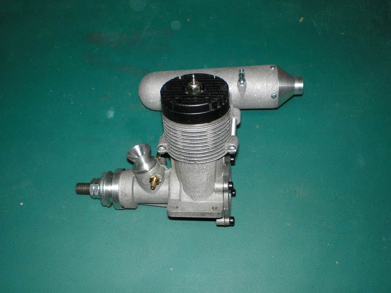

Here is a picture of the new
fox .60 CL Stunt modified with a Super Tigre nva.

  The case looks idenetical to the RC Eagle's of the 1970's except not as shiney

They will have to do something with that short crackshaft bolt if they want
to have some decent sales.  Most using a motor this big will want to use
a spinner!  Not too easy having to use a different ( specially made?? )
prop nut, AND counterboring props - not safe!!  :X
It does sound like a promising motor, if they iron out the problems!

But why the short muffler lugs again? To save weight?!

That would be my guess, at least unlike the Fox 35 these look like they are thick enough to hold a muffler.

If like Mike says this is similar to a previous Fox 1970's design, I bet that's the reason for the short lugs--they are re-using the original molds (or whatever they use to cast the crankcases.

A remake of the old Eagle, a real horse of an engine and a fine cl stunt motor...
Too bad that it is not a steel sleeve with ringed aluminum piston.....guess that I will just keep running the two Eagles that I have..... LL~
