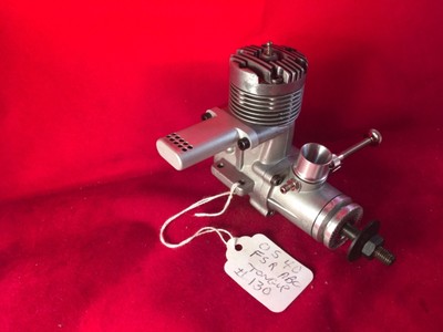

I'm interested in reversing the center section of the crankcase on my FSR to put the exhaust port on the other side.  I want to install it inverted and prefer the port (and muffler/pipe) toward the outside of the circle.  I understand that the piston and rod must maintain the correct orientation with respect to the crankshaft.
I imagine it'd work ok - after all the old K&B Greenheads had the exhaust port on that side and they run ok.  But not having run it yet, I don't know what to expect.  Has anyone else done this already on their FSR, and if so did it work ok?

Yea , you reverse the cylinder ( block ) & piston & liner. So the ROD stays the same on the crank .
Theres the OS 40 & 45 in ringed & ABC . Plus Magnum , Royal , ASP & Thunder Tiger Clones & a 46 . The ROYAL Crank is closest to the OS 40 - S stunt crank , in Timing, or better . But doesnt have the fancy machining on the crank web the OS does .
The OS 40 FSR - S to give it its fancy title , ran a differant crank ( timing ) but same P/L set up . Ringed .
Bob Hunts 40 FSRs ran Nelson Chrome Liners with some fancy Ring . Accoring to MAN Nelson column . Didnt say if retimed but Id think 130 - 110 .  :P
This being wot tames a HP 40 , which is a similar injun ( Must check if the liners fit .
To digress further , the next series OS , the SF , theres a C/L STUNT Version . I imagine it also has a specific crank .

P bleedy S , the FSR FOUTY FIVE & the HP have the same liner O.D. AND Head Bolt P.C.D. , and closely comparable port hights .
Thus you get .42 Cu. In. with HP Sleeve , in the 45 FSR case .
or FOURTY FOUR cubes , Seven with FSR 45 P/L in HP case . ( 1/32 " overbore - 0.8 mm )
Rods are same big & little end diameters , might need radius on piston cutout edges to clear crank / backplate / disk .
ALSO tho the OS 45 FSR ABC piston is LONG and alows ' dropping the liner ' the magnum is definately not so .  >:(
With the 40 OS your stuck with the FP as a non ring swap out , unless someone comes up with something else .
Ive found the overspeed / inabilty to stay on lap time insufferable with the OS FSR & clones . The cowl top vent seems t 've finally licked it .
Cant be bothered with the complexity ( structurally ) of a tuned pipe , or the expense . More'n one ways to skin a cat . As they say .  H^^
All my FSR blocks are reversed - Ex Out . Couldnt find a picture & gotta ' diss load ' a few pictures to get anymore on the phone camera .
