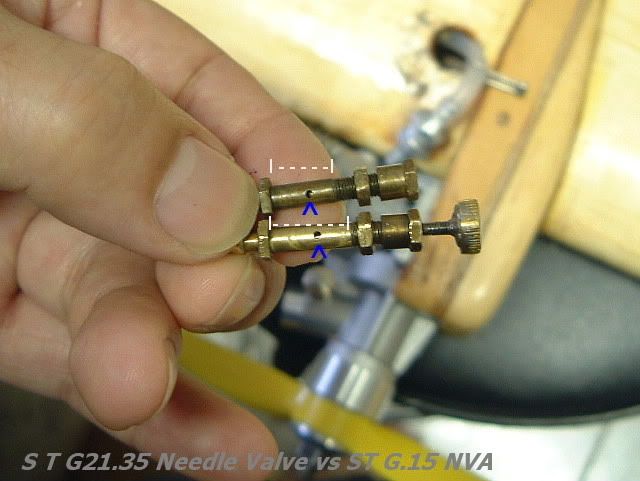

Is the spraybar assembly for what is listed as for the G-34..will that fit in the older ST G-21 and C-35 ST engines of yesterday...They certainly look the same, but don't have any info as to size..diameter, etc...
Re: ST needle valves and spray bar questions.../
« Reply #4 on: November 15, 2007, 11:30:16 AM »
I believe they're all the same size (.155"), the difference are in the location of the spray bar hole (where the fuel comes out.. see pic below), and where the thread starts for the mounting nut.  Stuka Stunt Works has 3 size of the ST NVA in their product section.

I haven't gotten my hands on the G34 NVA, but the G51 NVA is pretty small, smaller then the G21/C.35 spraybars.  Unless the G34 NVA is larger then the G51 NVA, tower doesn't offer one that fits your engines.

HI Joe
Much confusion on the Super Tiger NVAs. I do not know why they list 2 differant ones for the G-34 and the G-51, I sell both of these, and as all of the engines I get in have the exact same NVAs in them.
The NVAs that come with the new G-51 and G-43 are setup for a .510 spacing.
 These NVAs are basicly the same size as the older 15 St engine used and also the plain bearing C-35 and S-35.
 They do not fit the  G-21 35.
The spacing on the new G-34 is .600 and the G-51 is .715. So using the NVAs through the case as normal  will NOT work. Both of these engines have restrictors that are milled small in the middle and the 15 size NVAs installed.
I hope this doesn't confuse you more but the NVAs that Tower sales are the small 15 size.
If you want ones that will fit the  G-21 35, 40 or 46  that would be the Mid size, RSM has these along with Aero products.
If you want ones that fit across the case of the  new  G-51 or older ST V-60 you would want the large NVAs. These are also availble from RSM or from Aero Products.
Options are The PA type NVAs  and the  Enya NVAs, I have those here also.
