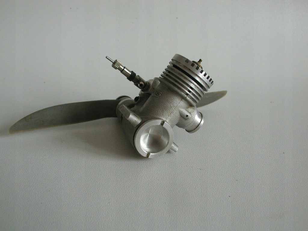

Re: My “new” MVVS 2cc Diesel went rogue today!
« Reply #9 on: July 06, 2022, 03:58:39 PM »
https://5.allegroimg.com/s1024/0c3bc7/f5b0b8734128ba9b792bb8dc1a75
Is this it? I googled for "MVVS 2.0 cc images" to get the link. This was the only picture. It appears that the head bolts down like most, leading me to speculate that the cylinder was misaligned and/or the head screws were loose. When you buy stuff on eBay, this is apparently pretty common...usually Fox or McCoy engines with the cylinder in backwards or piston or rod in backwards. How did you come by this one?  H^^ Steve
Offline frank mccune
  • Posts: 1627
« Reply #10 on: July 06, 2022, 05:44:09 PM »
     Hi Steve:
     Thanks for the reply.
     My engine is a bit different than the one you posted.  Mine is a Diesel with a
rectangular exhaust port and has muffler lugs on the side of the case.  The head is smooth with three screws holding it onto the engine.
      I think that I bought if off E Bay for very little money.  Another one came up NIB for twice as much and I had to purchase it as the only bidder.  I wanted a new Diesel engine to start from the beginning now that I learned a bit about breaking in engines.  I am on a quest to learn how to hand start a Diesel engine. Lol  A new purpose built Diesel may be the answer to my quest.
