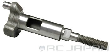

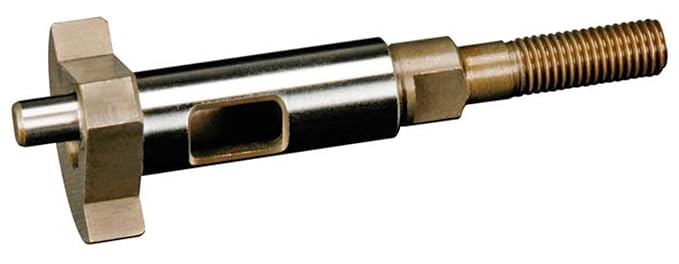

Heres a liddle pitcher of a crankshaft or two ,  :)
Mebee an EARLY one with all the Fancy Fandangular things .
Not So Fancy , Fandangulariclly .
Checking the OS parts thing , the 40 & 46 run the same crank ( part No. ) A 35 FP will ' 40 er ise , FP crank fits LA ?? , so ' a choice ' of cranks .
Later less fancy , less counterweighted . So comparison maybe only valid with this taken into account , perhaps .
FSR Cranks , at least in the clones , are only ' Flat Flank ' Flywheel / big end set up ,
where Some are Fully Machined on the rear face , for a more concentrated counterbalance .
Or more eliminated weight opposite counterballance .
Thus :
Just thought Id point it out , for what its worth .

Would any of our inspectors/machinists/engineers care venture an opinion on whether that top crank picture is of a forging or a casting? I'm of the opinion that it's a forging, but I've not seen all that many steel forgings or castings...lots of aluminum forgings and castings. That's the LA crank. The middle one should be an FP crank. I don't know about the bottom picture, but it is not an ASP/Magnum crank. The reason I'm asking is because Leonard Neumann said that the LA cranks are from a casting, which I tend to disagree with.
FWIW, I have read that the FP .35/.40 cranks interchange with the .40/.46LA cranks. I also wonder if OS changed the crank counterweight when they changed the FP's from the iron piston to ABN. I would kinda like to know what the difference would be, if any, in the static balance. And I don't know how to describe the difference. I'd figure that one would hang some weight on the crankpin to get it at 9 or 3 o'clock. The cutout for the timing port would make a little difference, but probably not a lot. Is the counterweight made offset to compensate for that? I doubt it.  D>K Steve

The top crank is cast, not forged.
PS--I tried to post a comparison photo of two cranks that highlight the difference in appearance but it crashed my answer. I will try one more time...   Ok. This time I didn't kick the klaymore. Cast part is on the left, forged on the right. You don't get a pebbled surface on a forging unless you fabricate pebbled forge dies. You don't get that from machining, so the only way is from really uniform erosion (no way), or from shot-peening the die to improve surface durability (it wouldn't be that rough relative to the size of that part.) Or, much more likely, the roughness would come from scale as the part was reheated and subjected to a series of forge steps. The pebbling doesn't look like that to me. My 1-1/2 cents worth....

Online M Spencer
Re: LA40 vs LA46
« Reply #13 on: October 22, 2018, 08:41:30 PM »
O.K. , this is what i was looking for ;
Early Crank . The Flash Machining there on the rear face , was eliminated later .
Thus COUNTERWEIGHT on earlier engines , is more .higher balance factor % number .
Though THIS is a 20 / 25 crank ,
CRANKSHAFT 40-46LA.35-40FP -  OS-23302000
Which is where we started . the ' Vibes ' , crank & or abc , are relevant .
If both cranks were the same , & both were abc , there might be something else ,  :P .

   Hello Matt
                          I think that he last crank on your post is a Tower.40 crankshaft. I bought one from Tower Hobbies way back to try on my .40 LA.
