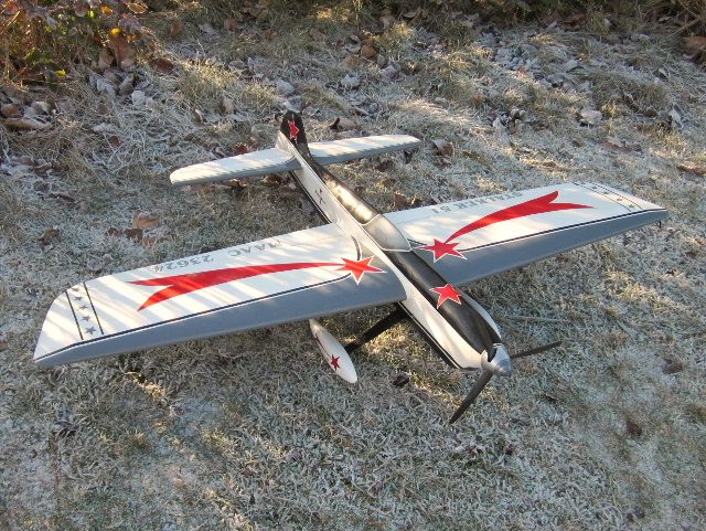

Minor correction on my Stalker 51 prop.  It is APC 12.25 X 3.75 with 1/4" off each tip.  Wow!  I didn't realize that is pretty darn close to zero pitch!
Also, checking my notes, fuel load is 4 1/4 oz.  Keeps going down!
Both of them are pulling a Brodak Legacy, with mucho cosmetic mods.
I guess these are early pictures, with wood props!
« Last Edit: August 30, 2012, 03:46:04 PM by FLOYD CARTER »
