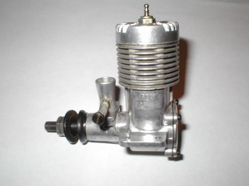

Hello fellow Americans!
I've picked up a chrome fox 25RC off ebay, believing it to have a 0.738" bore (aka early models).
To cut a long story short, the piston in my 29X is cooked. Maybe the piston on this ebay puchase would be suitable; (however on closer inspection I discovered these later engines to be 0.680" * 0.680".
So as I've completely stripped this beauty, I would be grateful if anyone could tell me the correct threads Fox used for these later units.
..........it ain't UNC is it?
Tim

Re: Fox 25RC headbolt sizes
« Reply #4 on: May 05, 2014, 10:03:33 AM »
I vaguely remembered having trouble finding screws for a 25, (4-40s didn't fit), so I dug one out of the stash.  If it's the shiny case, 4-bolt backplate 25 like the one in the pic, they should be 3-48s.  The earlier 3-bolt back plate 25 used 4-40s, as did the BB IIRC.
« Reply #5 on: May 05, 2014, 10:06:11 AM »
Definitely they are 3-48. While your at it get the necessary socket head screws from Micro Fasteners or RTL and ditch the really bad Phillips screws that Duke used to save production costs.
« Reply #6 on: May 05, 2014, 05:34:50 PM »
Thanks Dennis, that's saved me alot of hassle.
