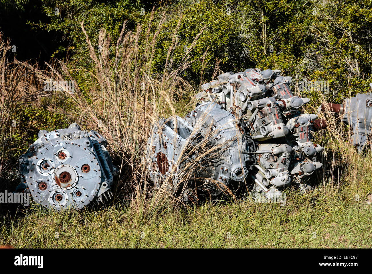

this ones a bt stuck , but it should come right .
some people seem a bit careless with their aeroplane engines , too . Every picture tells a story .  :(
