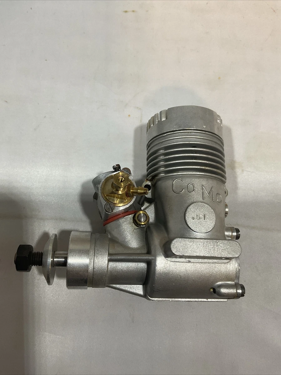

The como 51 pdp is a 15 mm shaft 1 mm overbore 21/46 more or less , but has very high sleeve timing . same wt. & fit as G 51 bar shorter nose , could be got low timed with a long skirt piston .

( Frank run the .60 Como 51 in the Martin Baker M B 5 . ) c.o. your archive research organiseation . !  H^^

A head or Two .
Your Big Art / adamisin . Typical WEDGE . above .
Rbt. Zambillie's ' open chamber ' ?  Hemi .
https://i.ebayimg.com/images/g/oaoAAOSwNh9j7TTF/s-l1600.jpg picture'l likely drop out . BAFFLE is irreklevat to THIS issue .
COMMON to Many . ST 40 , K&B 40 , & Irvine 40 ( Wide Squish , could all have been chamber off the same tooling . Somebody assumed somebody new someting . Or they couldnt get it better otherwise themselves .
