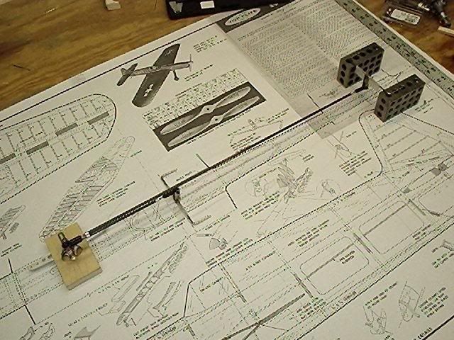

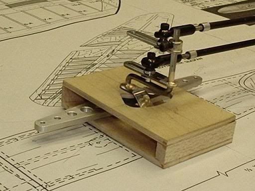

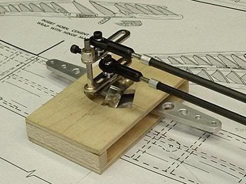

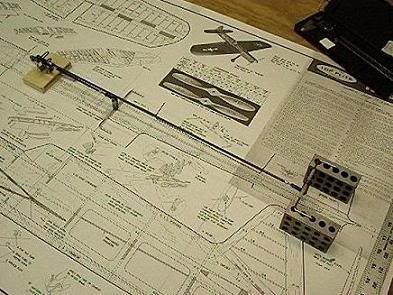

I wouldn't say its a no-no. I designed a completely adjustable system for a GB Nobler and I can reduce deflections to zero, therefore I can get any ratio I want. I can't lead with flaps or elevator, but I'm not sure that's necessary. Unfortunately I haven't had allot of time to play with the Nobler, but the first set point was at 2:1 (elev-flap) and I liked it there. The model is quite light, so I'd expect to use less flap, I just want to find out how much. Experiment, go for it, learn something maybe all of us can use.
Re: FLAP/ELEVATOR MIX ?
« Reply #3 on: March 26, 2011, 08:19:24 AM »
Here are pics of my "infinitely" adjustable control system. Designed to be used for testing E/F ratios

Holy cow Randy!  BW@
That piece is exemplary of design and craftsmanship. Fantastic silver solder work and superb machining.
Hopefully some day you will have some time to create an Excel or similar file with tables on deflection angles.  D>K H^^

Thanks Rafael, maybe I'll do that, but don't hold your breath as sporatic as I've been the last few years. I get all pumped for the season that other stuff just seems to get in the way.
