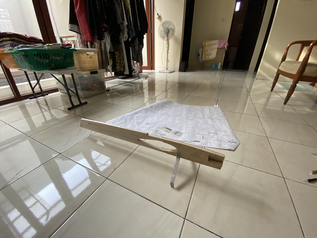

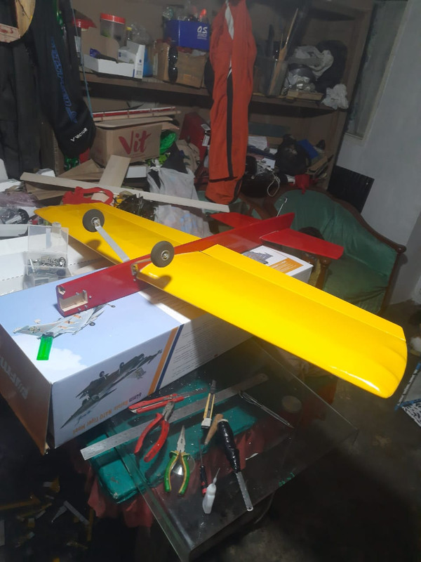

Hi, I just wanna share my building journey of a Brodak Cardinal.
I知 not an expert builder, but I love building planes. My building skills are pogressing, and this project is actually done way better than my Banshee. Soon, I値l become a better builder.
This project has been going for almost 10 months, and still not finished yet due to my limited time to build.
So, let痴 start:
- Picking up the package at the local post office.
- Unboxing time
- Setting up the Wing Jig
- Assembling the Wing Panel
- Fitting the wing and stab into the fuselage
- Fitting the landing gear and tail wheel
- Reworking the wingtip
- Covering with Monokote
Just few more steps left, and I will still update this post, and hopefully I can finish it by the end of this month.
I can稚 wait to fly this plane.

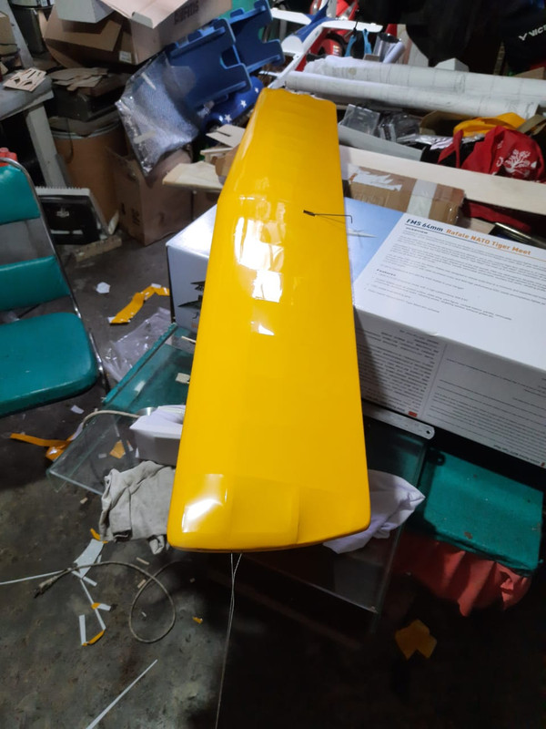

I would say that your building skills have greatly improved.  That is a first class MonoKote job.  It looks about ready to fly.  It appears that you used the plan control setup which is a good starting point.  With the horns external it will be easy to slow them down if they are too fast or speed them up if they are too slow.
Keep us posted - Ken
