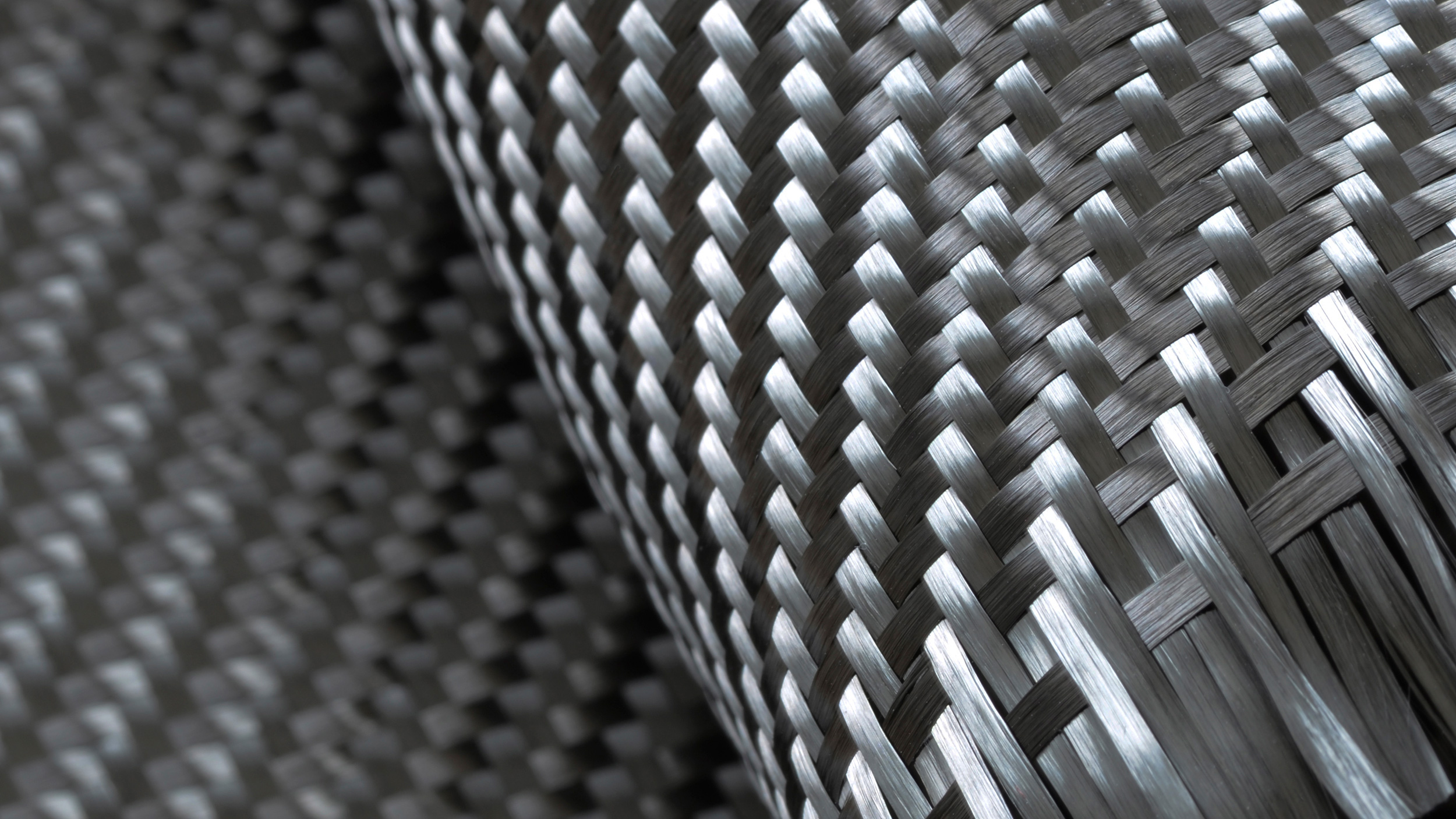

Geez Tim, way to get techical about directions!  ::)
I can tell you though that once it all turns to fuzz it is very much a ball of omnidirectional uselessness!
What I can say is that veil, or *tissue* as it's known in the industry is more of a felt than anything.  The fibres are long, but don't necessarily go in any specific direction, and cross back and forth over themselves, so not really that structurally strong when looking at it from a purely fibre orientation view.
 Chopped strand mat is different in that it's a whole mess of small straight fibres that get connected together in the resin, sort of like having millions of unidirectional fibres, in all directions, which makes it structurally usefull,and 'neutral' (not biased or having any grain).
Woven roving is a bunch of tows (multiple strands running in the same direction) weaved across each other.
Unidirectional rovings are a number tows all facing the same direction, but generally stitched together for ease of laying up.
Carboline is a bit of a mix the tows that would normally make up a weave have been spread out, like a uni, but very thin, and then another set of twos are set at a bias underneath.
Textreme is similar to weave, but the tow instead of being a bundle (roundish in cross section) is flattened out and then the flat tow is weaved together.
Carboline and textreme are useful to us as they contain a very high number of strands for their thickness, which means less resin, and correspondingly less weight for a given layup.
The trade-off is price.
There may be some benefit in considering doing a "Disser" style layup for a flap, where tows are laid in a grillage over the surface to give better torsion resistance, without having to resort to expensive lamintes like carboline or textreme.
Here's a disser wing for reference.

Thanks for the info on Carboline. From your sample photo, the uniformity seems a little variable. If so, that might make it a little rich when filled. If I had some in hand, I'd sure try it on some flaps!
http://carboline.info/price

No, the carboline is the opposite of rich when filled. Because it has zero intersections, there will be no excess epoxy used compared to woven cloth. It is SUPER THIN. That is how they make DLG wings that weight 110g, and will still take a full power discus launch.
Additionally, cloth is normally terrible in compression, even carbon, since the fibers are kinked and not straight to begin with.
Hence the use of uni-carbon, when you need stiffness to bending.
It used to be that you would have to use woven fabric to get torsional strength, but now, you can have 45/45 fibers without the dead weight of pooled epoxy at the intersection of the weave, AND without the kinks in the weave, that makes the fibers much weaker in compression.
This is not what you will want to make severe compound curves though, for the very same reason that it works great for wingskins. And it is not easy to distort.
