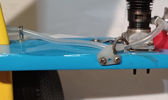

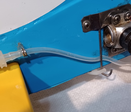

I've tried a few ways to clamp off the fuel line when using bladder pressure.  As I said, I'm too slow and clumsy to use the hemostat method, so other methods were tested.  After a few tries, I found the method that I like best.  It uses a wire that pivots at the top of the fuselage, and clips at the bottom of the fuse.  The clip is made from an old 1/2A control horn notched and screwed to the bottom of the fuse.  It's very convenient to clamp off the fuel line to refill the bladder, and then when ready to start the engine I hold the nose between thumb and fingers, with the fuel line trapped between my thumb and the fuse.  Then I just use the other thumb to flick the wire forward out of the clip, and then flip the prop.
I've been thinking for a few years that I need to redo this clip, as it's just a wire bent at an angle and pushed into the fuse with the aluminum covering it.  I should really bend up a new wire with a loop at the top to sit under a bolt and washer.  This was a prototype method that just worked, so I never put more effort into it.

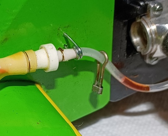

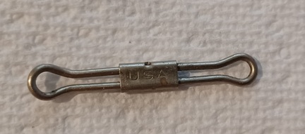

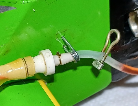

It only works for a slab sided fuselage, and only if I have a lot of real estate right behind the engine.  So, an easy method is to use a small Luxon line connector.  Not the smallest Luxon clip, but the next to smallest, I think.  I make sure the slide is centered and then heat the slide up with a soldering iron.  I flow solder into the slide, making sure the slide is filled solid.  Then I take a Dremel tool and cut through the middle of the slide.  I get two fuel line clips from one Luxon control line clip.  And yes, I know I need to clean out the fuel line, but I'm replacing the fuel lines anyway.  I replace the fuel line every season, and replace the latex bladder tube every couple of weeks when flying.  Unfortunately, I haven't done much control line flying at all the last couple of years.
